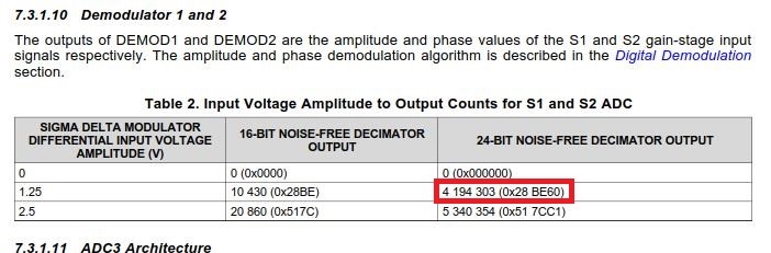

Team,
the PGA970 datasheet (SLDS201A –JANUARY 2016–REVISED DECEMBER 2016) may have a false value in table 2:
HEX value 0x28BE60 should be decimal 2670176 instead of decimal 4194303.
Is this correct or am I getting something wrong?
