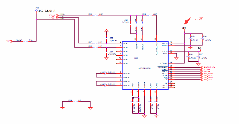

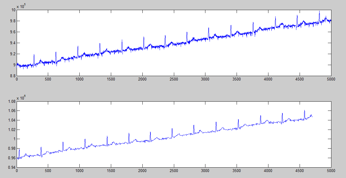

Hello!great TI engineer:
I have been debugging ADS1291 for a month now,The main problem now encountered is the failure to collect ECG signals from the human body.
I hope you can give me some suggestions and help me to locate where the problem is. I have almost no direction.
The product that is currently being developed is a wearable device that uses the ADS1291.The ECG signal on the ECG simulator can now be acquired.The ECG signal is as follows:The waveforms drawn using matlab are the raw data above and the filtered data below.
The following is the collection of ECG data on the wrist, no ECG signal,The waveform is as follows, and the original data is in the attachment. The waveforms drawn using matlab are the raw data above and the filtered data below.

The schematic of ADS1291 is as follows:The positive electrode of channel 1 and the electrode driven by the right leg are in contact with the wrist of the left hand; the electrode of the negative electrode of channel 1 is in contact with the electrode pad with the index finger of the right hand when measuring.

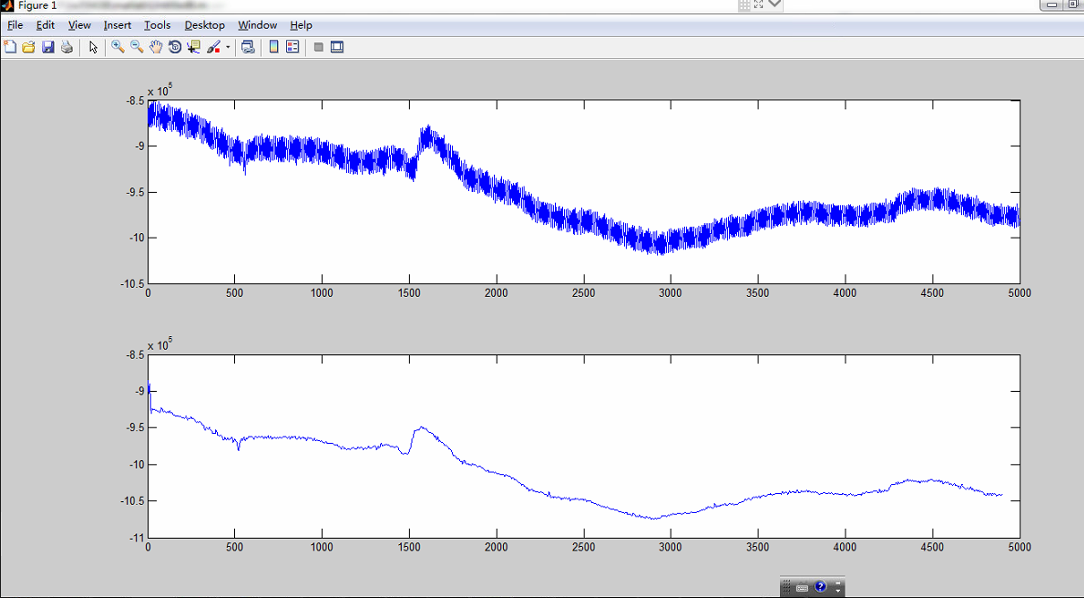

    The data you recorded from the ECG simulator looks very good! I suspect that your main problem here is the large contact impedance between your electrodes and the surface of your skin. Try using electrodes with more surface area and add moisturizer/gel to reduce the impedance as much as possible.
    The RLD can be measured directly by setting CH1SET[3:0] to 0010. The output of Channel 1 will become (RLDOUT - RLDREF) times PGA gain.

  • Thanks for your post. I still have 2 questions:
    1. ADS1291 powered from  unipolar supplies(DVDD =3.3V,AVDD = 5V). Please see my schematic diagram。

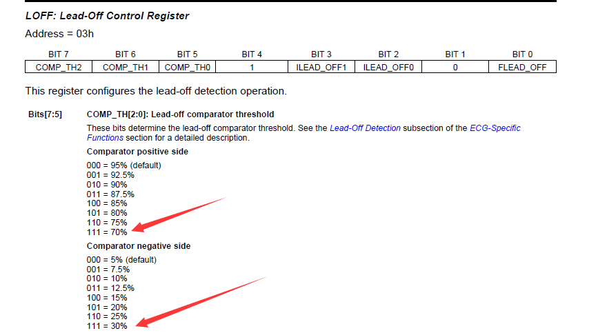

     What is the value of  70% in the red arrow in the figure below?  and What is the value of  30% in the red arrow in the figure below?
    70% for unipolar  5-V supply (+5V/-0 V) would set the positive threshold at 0.70 * 5 V + (0 V) = 3.5 V.
    30% for unipolar  5-V supply (+5V/-0 V) would set the negative threshold at 0.30 * 5 V + (0 V) = 1.5 V.
    Is the above calculation correct?

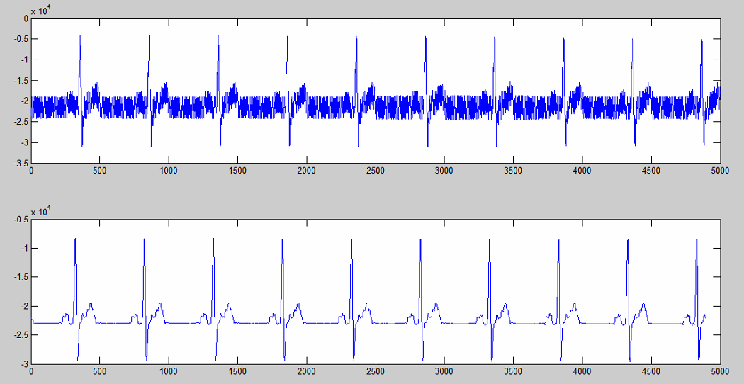

    2.I can now collect ECG signals from the human body. However, the signals of some people who are thin are not very regular(Picture 2), and the signals of fat people are very regular(Picture 1). Will the parameters of the registers need to be adjusted when acquiring data? If necessary, what register parameters need to be adjusted? After setting the register parameters, does it not need to adjust?
    Picture 1
    Picture 2

  • Hello Yihui,
    1. Yes, your calculations for the lead-off comparator thresholds are correct.
    2. The skin-electrode impedance can vary a lot for different people, depending on age, race, gender, overall health, etc. You will have to improve the electrode contact quality when you cannot measure a clean ECG signal. The ADS1291 register settings should not need to change.
