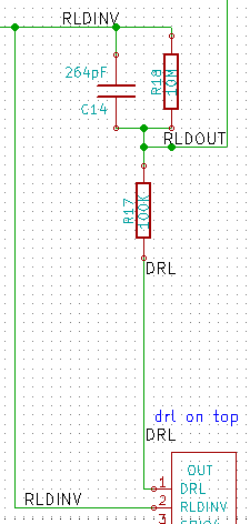

  • Now I want to have a multiple device setup with DRL
    I set all pins to effect DRL
    RLD_SENSP    0    b1111 1111        all bits effect RLD
    RLD_SENSN    0    b1111 1111        all bits effect RLD
    is that correct? For a basic testing I would hook this to all the pos. or neg. inputs and hook them up to a function generator pos to one side neg to another to create a wave for the system to mesure?
    RLDINV is common on all ads1298 modules.
    I am referencing page 62,63,60 with the patent protection resistor.
    What kind of test setup documentation should I be looking at? Or what documentation would you sugjest how would you test this it a white breadboard?
  • I was thinking of taking the end off some ear buds and using my mp3 player as a function generator to test this out.
    I would mesure with a metter 1v p-p that should be safe by adjusting the volume then lock the keypad on my mp3 player it is a little sandisk and use audacity in linux a sound editing program to make sine wave MP3 and other waves to mesure with the ads1298.
    I thought a 1k resistor or some setting would work any sugjestions to keep it safe with the ads1298 or if I found a function generator used any sugjestions their is the 100k patent protection resistors on every input pin of the ads1298. Fallowing the data sheet.
