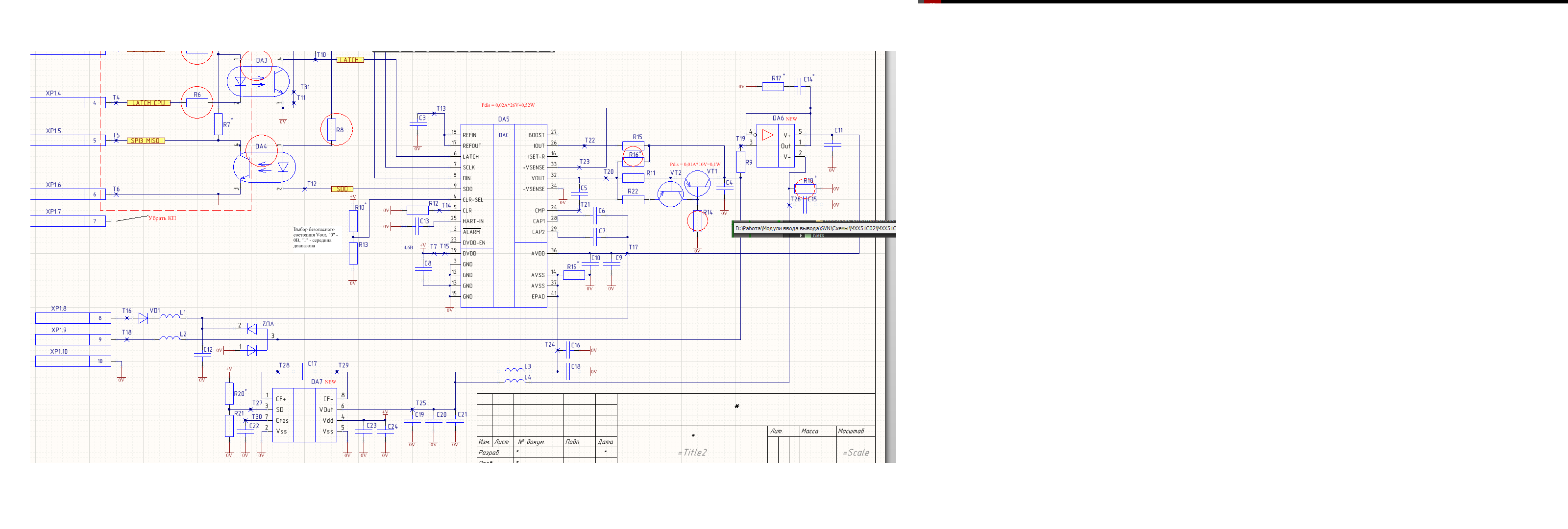

  • Hi Vladimir,
    Can you provide a schematic for this? It seems strange that adding a series 5 ohm between the supply and AVDD would cause device failure. Is this resistor for current limiting in case of fault?
    Garrett

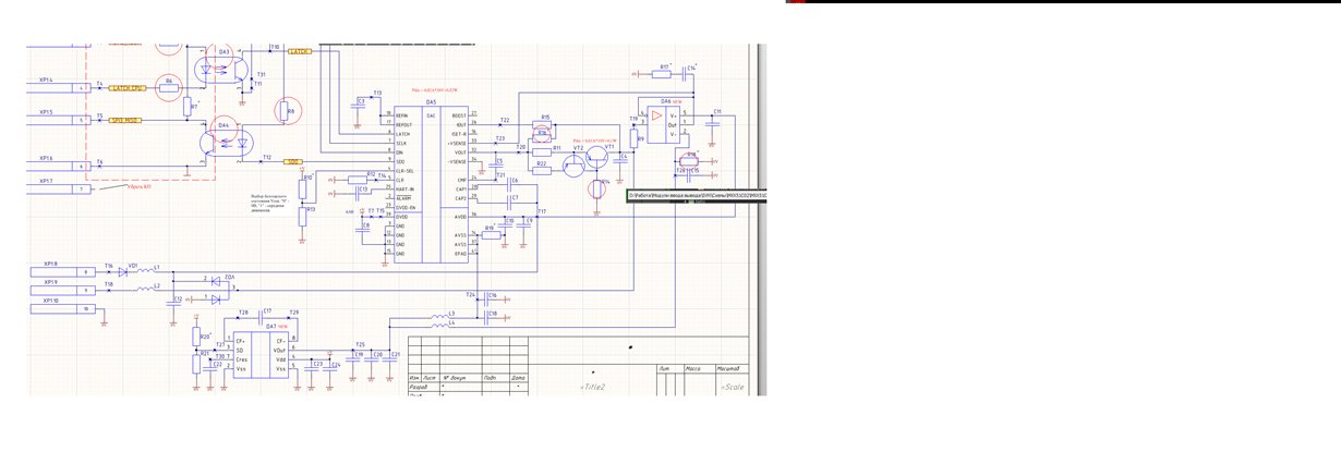

  • Hello. I'm customer, who have this problem. Vladimir asked me to send schem. Fault happens when no any currentlimiting resistor. In this circuit I don't use DA7, instead of it there is R19. C23 is 10uF, but it doesn't influence on the problem, because I deleted it and fault happened whatever. Currentlimiting resistor was put instead of L1

    I'm wondering if L1 is coupling with the capacitors causing an LC response that could cause overshoot and ringing, especially if the rise time of the power supply is short.

  • The fault occurs immediately after applying power. L1 isn't an nductor, it's a ferrit bead (FB0603-0,2A-2500Ohm (100MHz)-25%-0,8Ohm).

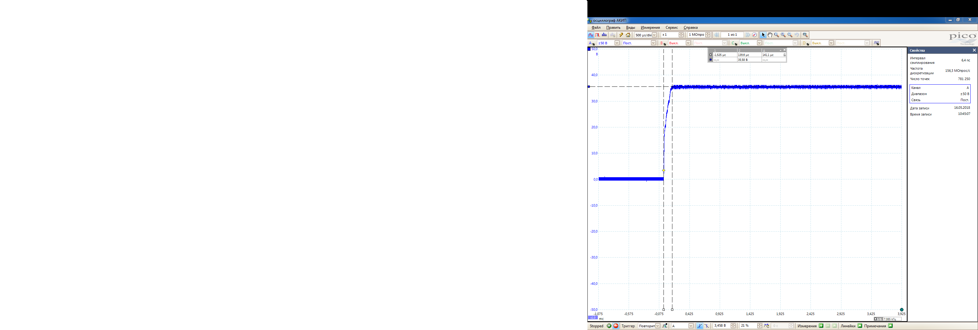

    2. There are interesting cases. Before I looked at this voltage in moment of switch on. Diagrams didn't have any spike, overshoot. Now, with the first sample diagrams were good. They are below
      This is small step which is on reason of C23 - 10uF
    This is without C23.
    Beacause of I coudn't make DAC default, I took other sample
    Diagram on it was below
    There is overshooting. The both sample are identical, and there were DAC fault on both of them before, I had replaced DAC on both of them.
    I cheked other samples and found that more part of them had overshooting. I found that reason was VD1. How I understand, some of diodes have degradated, and their resistances have increased. There aren't any overshooting in this case. And visa virsa there is a spike when diode isn't degradated. So decision of problem is putting resistor seriesly to L1. It'll do no degradation of VD1 and fault of DAC.
    3. Lower voltage of power supply and slow rise time (softstart) of it doesn't make the fault. Fault happens only when I put power supply, which has been switched on earlier, and voltage of it is 36V.

    I suspect that this overshoot is causing damage to the device. It looks like the one you show is less than the absolute maximum rating for the AVDD pin, but some may be greater depending on rise time.
    The cause of this is some LC combination with a small resistance. This could include parasitic values from the PCB and even the ferrite beads will provide inductance if the frequency is high. When you add a small series resistor you will reduce the quality factor and damp out the overshoot and oscillation. Using a series resistor should be an okay solution since even with the 5 ohm the power dissipation will be small. Reducing the capacitance at the AVDD net should also help reduce overshoot.
    Are you sure you are referring to C23 in the above post? I thought you said you didn't use DA7 and this is connected there.
    Another option is to control the slew rate so the edge is not fast enough to cause overshoot and ringing.
    Garrett
  • Hi Garrett. C23 is on board. Thanks for your answers. The problem is resolved, so it can be closed.
