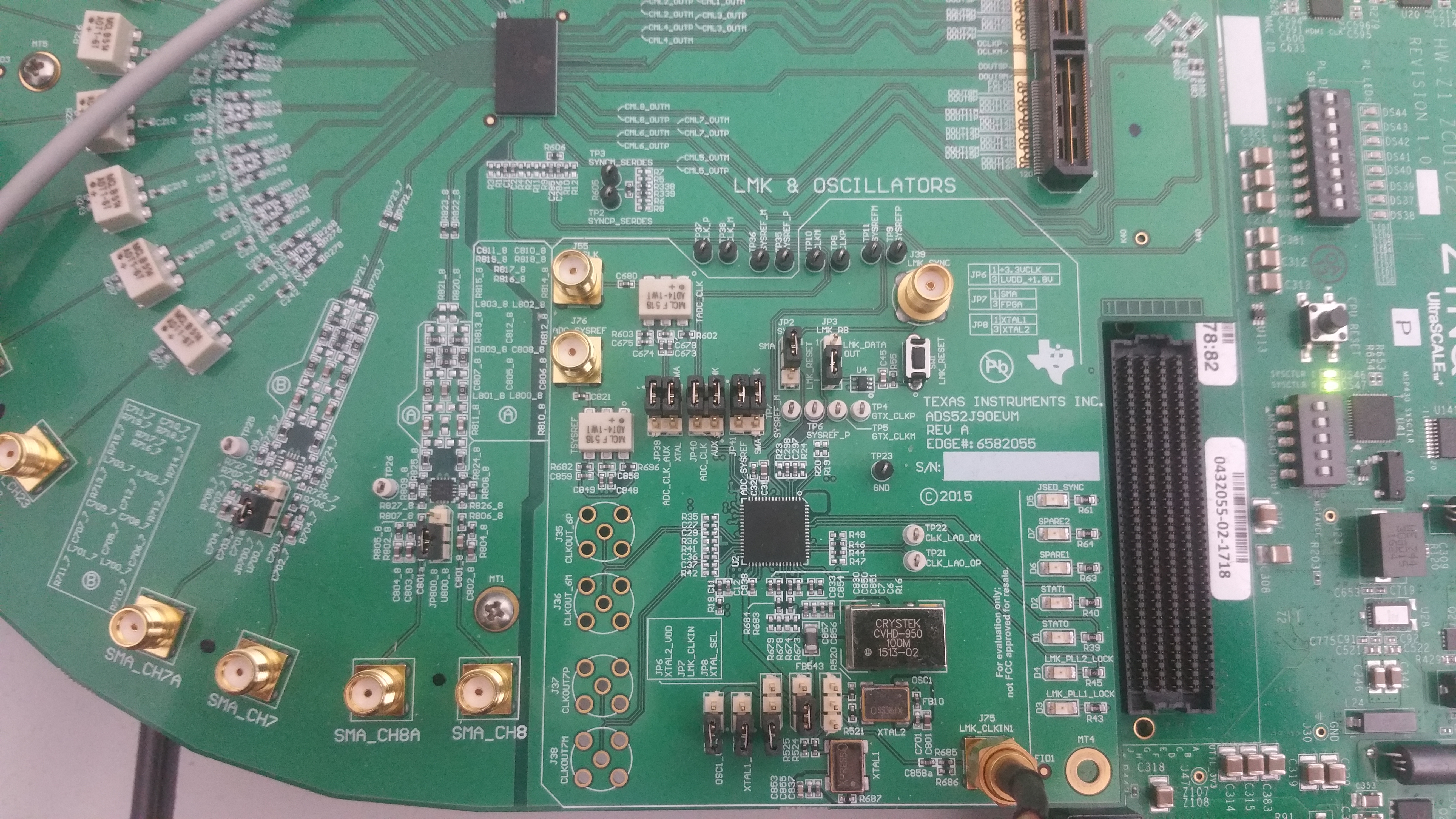

  • Hello Rizwan,
    Can you provide the clock configuration jumper settings on the EVM?
    A snapshot of the EVM showing the jumper configurations on the bottom right section will also do.

  • Hi Praveen
    Thanks alot parveen for your reply. I have attached the photo of my EVM.
    Currently i am supplying 120 Mghz at J75
    I have checked some Vivado reference designs, and in those designs clock signals are connected as i described above. That's Why i wanted to know why i am not able to see the clock ( FPGA_CLK) on evm. this clock is also observableon test point TP22 and TP21.

  • Hi Rizwan,
    I checked the LMK register configuration and the LMK is set up to generate the FPGA clock but the clock output buffer is powered down (register address 0x126).
    You may want to enable the clock buffer.
