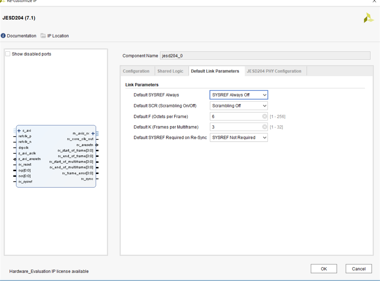

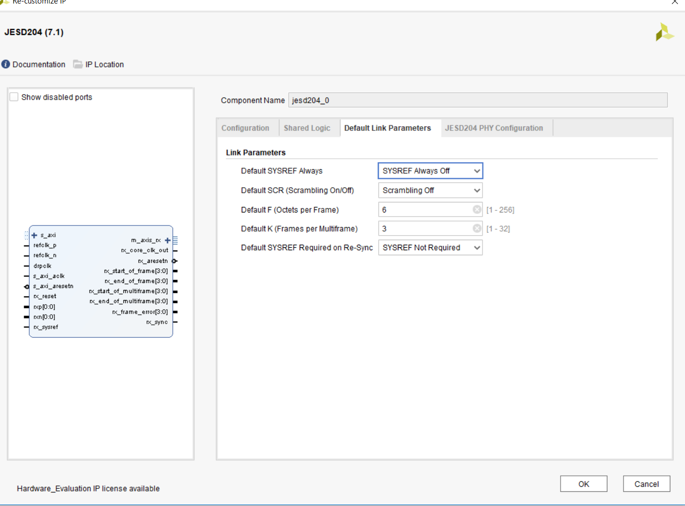

I am using TI's High speed ADC board ADS52J90EVM. I am using ZCU102 to read ADC samples. I am not able to get ADC samples at the output of jesd ip core in vivado.
I have invested a lot of time in it, it seems that i am not able to configure the ADC properly.
Attached is my ADC configuration file, ADS52J90_16ch_SINE_4L_12x_12b_GBLCLKDIV1_FSDIV3_SYSREFDIV24_20x.cfg
according to my understanding this congfiguration file has the following parameters
1- Num_ADC_PER_LANE = L= 4
2- F = 6
3- K = 3
4- SER_DATA_RATE = 12x
5- N’ = number of bits = SER_DATA_RATE= 12
6- ADC_RES = 12 bit
7- SINGLE CONVERTER PER OCTET MODE = 0
8- Scramebled disabled ( ADC address 52 h = 0 )
My Question is

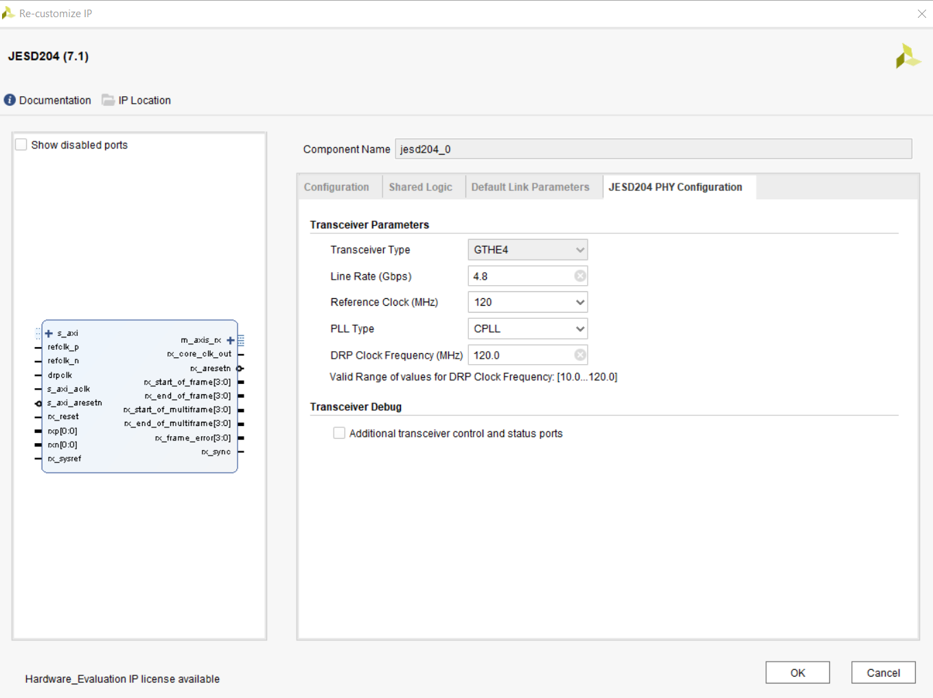

1- What would be the Line Rate = ??
2- How much frequency I should apply externally = External Clock = ?
I need this information so that i can configure the following parameters in Vivado core. Could you please help me out in setting the right parameters.

    What is the sampling frequency (Fs)?
    Based on the configuration and assuming Fs = 40MSPS, the JESD lane rate would be 2.4 Gbps.
    Since the lane rate is above 1 Gbps, the input clock should be set to 1/40 of the lane rate which would be 60MHz.
    I do not have experience working with the Vivado cores.
    Let me check around to find out if someone could help set up the parameters for the Vivado cores.
