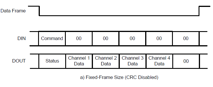

1. On Figure 51, I shows at the beginning of data transfer, the DIN pin should have "command". What command does this refer to? I don't find the corresponding command for data acquisition, so I send "Null" command.
2. Figure 51 indicates that every data frame should contains 6 * 32 bit data for fixed frame size setup. However, I have to transfer another 16 bit data before receiving the data frame. Below is the pseudocode that I write:

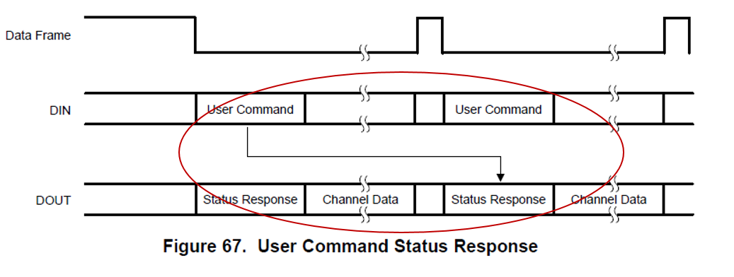

3. Figure 67 on Page 49 of ADS131A04 data sheet confuses me. Why would the response corresponds to previous command? Does this conflict with Figure 51?

    Thanks for your post. Just a quick note: I believe you are using an older version of the datasheet, so the figure and page numbers don't quite line up with your question. Please check the product page for the latest revision (SBAS590D). I assume your first question is referring to this figure below (Figure 54 in the updated datasheet):
    1. Sending the NULL command is fine during normal data acquisition. The corresponding STATUS word on DOUT will tell you the contents of the STAT_1 register so that you can monitor for general fault updates.
    2. I'm not sure what you mean here by sending "another 16 bits" before the data frame. Are you referring to the STATUS word length? All STATUS words are 16-bits and must be padded with zeroes at the end to match the data word size you've configured.
    3. The command status response waits until the entire command is sent and decoded, so it is sent in the next data frame. It does not conflict with the other figure.

    1. Steps 1 and 2 should occur simultaneously, where the STAT_1 contents are in reference to the NULL command that was sent at the beginning of the previous data frame. You should have seen this on the scope. Please attach a scope image of SCLK, DIN, and DOUT if you would like us to review it.
    2. Step 4 - is this referring to the same data frame at Steps 1 and 2? Understand that the ADS131A04 will not necessarily recognize this as a second NULL command, but rather an additional 16 zeroes to complete the first 32-bit word in the data frame. In other words, the Command Status Response will only be given for the first 16 zeroes on DIN. I believe you understand that, but just wanted to be clear.
    3. Step 5 - your SPI RX buffer stores the STAT_1 contents from Step 2 into memory while the "second NULL command" is sent in Step 4.
    After the first word is complete (NULL + 0x0000), you should continue to send 5 more 32-bit words (all zeroes) to the ADS131A04 in order to read the rest of the data in the data frame. Are you able to do that and read valid data?
