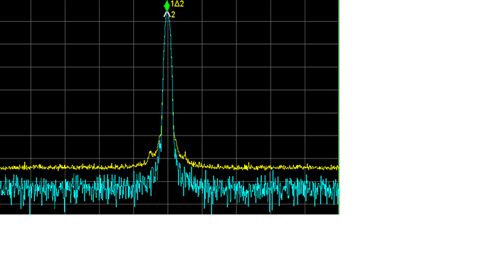

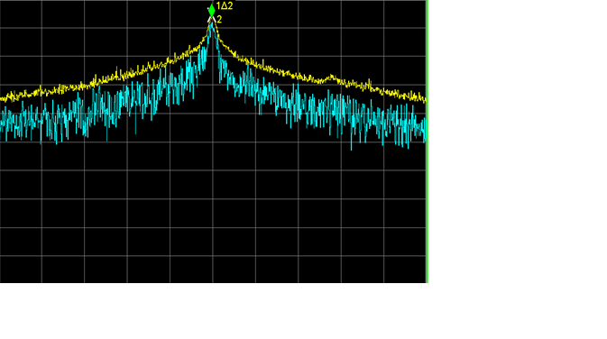

According to my customer, the phase noise is somtimes getting worse when temperature is under low.
The spectrum is as below. ("NG" is worse case.)
1) normal
2) NG
This phenomenon is not always happened under low temperature.

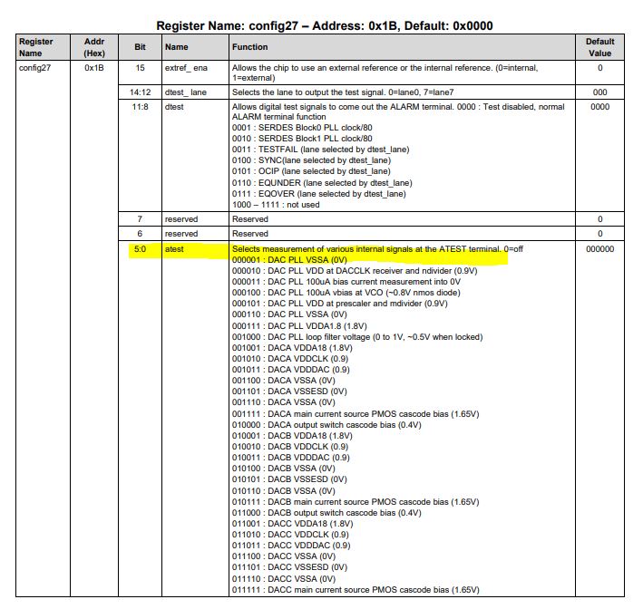

    I was referring to the ATEST programming. Basically, the engineer may use a voltmeter with respective to the ground to measure the ATEST pin (K9 pin of the device) and measure the internal nodes. The internal nodes are programmed by the ATEST registers in the 0x001b (config27) register. I apologize I made a typo on the ATEST register.
    I have pasted the register information below:

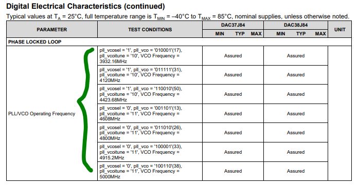

    We may need to review their configuration sequence. Please let us know if they can share
    If the DAC is in external clock mode, then I do not see the reason that lowering the voltage will help lower the noise floor.
    I suspect the customer is using the on-chip PLL/VCO circuit, and the tuning of the VCO circuit may not be set up correctly.
    Please double check (if PLL/VCO circuits are used) for their exact PLL_VCO_SEL, PLL_VCO, PLLVCOITUNE per their VCO configuration.
    If they are indeed correct, we may need to adjust their PLL_VCO code to see if problem is fixed. We may need to ask the customer for some units for FA afterwards.

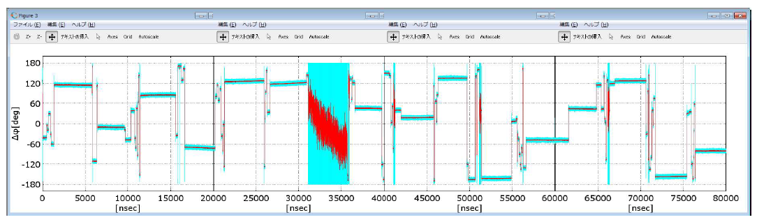

    In their application there are tow types of boards that use PLLs and boards that are not using them. The phenomenon that the noise floor rises at low temperature are happening in either case.
    When this phenomenon is occurring, the time interval varies depending on conditions, but a phase change occurs at intervals of about 4 us - 5 us.
    The following capture screen monitors the phase change when single tone is output.

  • Toshi-san,
    Could you please advise the expected phase change in normal operating condition? Should the curve be a straight slope line from 0degree to 360degree?
    The fact that phase is changing drastically seem to indicate some of the bits may be having error. Could the customer advise if they are using NCO in the DAC? Could they please try to use "NCO sync" and "Mixer sync" to trigger a reset to the NCO accumulator to see if the NCO is miscounting the sine/cosine wave internal to the digital mixer? If there are miscounts of sine/cosine wave in the digital mixer, the output phase noise could also be degraded.
    I suspect the temperature drop must have caused some power supply node (especially DVDD) to sag (drop in voltage) temporarily. This sudden drop in voltage causes bit error in the data path and caused drop in phase noise performance.
