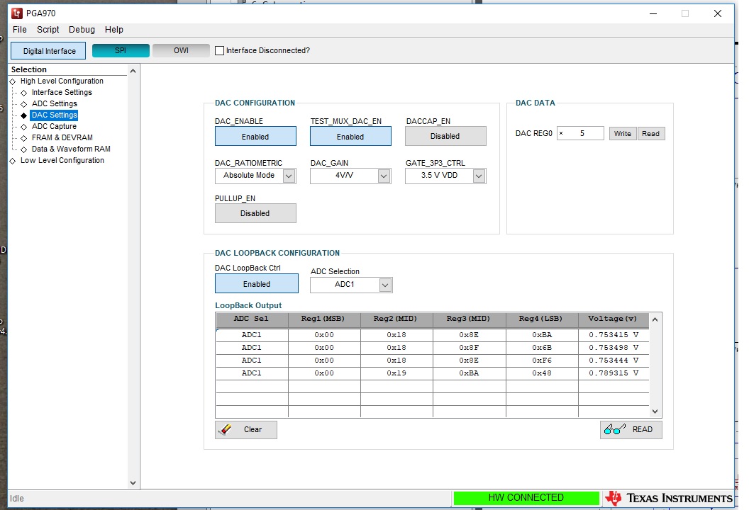

I'm using the GUI with the digital interface to command PGA970EVM,
I 'm generate the wave form, the sensor lvdt is connected, i can read adc1, adc2 with the GUI and it works fine.
I try to active the DAC, in loop back configuration mode i read back adc1.
I have nothing on OUT pin13 of the PGA.
How is the way to connect output pin with the gui? is it possible?
Thanks for your reply,
Best regards.
Yannick Bouchet

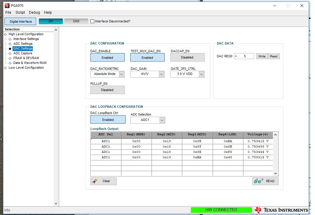

  • Hi Yannick,
    If you have the TEST_MUX_DAC_EN turned on, do you see the output changing when you set the DAC REG0 in the GUI?
  • Hi scott,
    Yes, if i change value of dac_REG0_2, then i can see the output change.
    Is it possible to have the result of adc1 or adc2 or (adc1 - adc2) on the dac out pin with the gui?
    Yannick Bouchet
