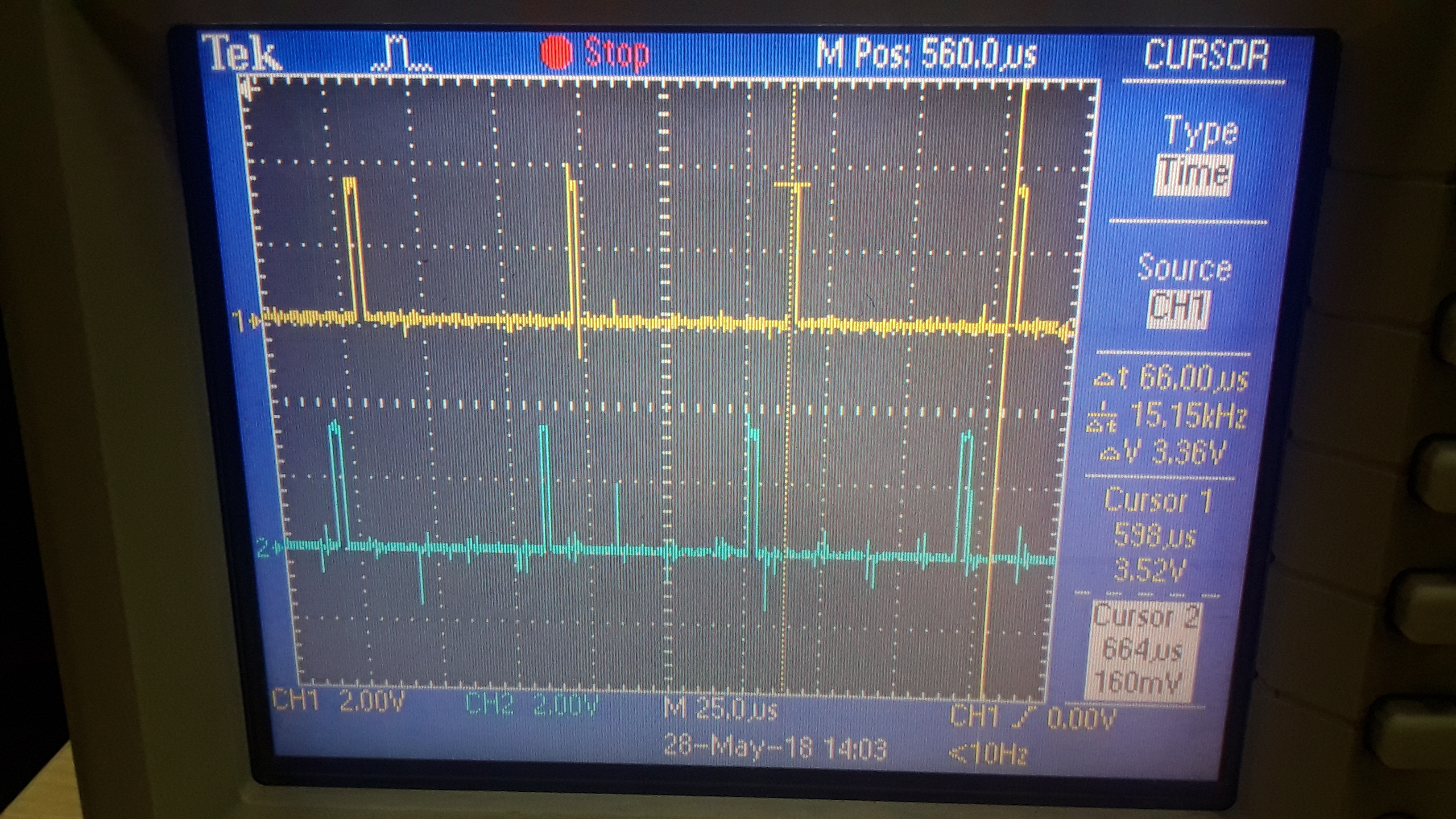

  • Hi Christopher Thanks for the reply,
    1.We are using different crystals(clock sources) for each ADC with same frequency(7.8 MHZ).
       But any way after device power on , we are making SYNC pin low to high , which actually synchronizes all ADC's at same time.
       If any thing i missed please suggest...?
    2.Attached DRDY signal of two ADC's at sample rate of 15K.
       If we check those signals, gradually DRDY signal shifts.
       So can you please suggest me the cause for  these issue (DRDY signal shift)......?
       DRDY signal shift:
       Gradually CH2 signal shifts to left side
  • Hi sreenath,
    1. When using separate crystals it's possible that these clocks are out of phase. When you issue the SYNC pulse, the actual SYNC operation will occur on one of the next internal clock edges. In this case the ADC's will be nearly synchronized, likely with 1-2 clock periods, which shouldn't be an issue...
    2. If I understand correctly, all of the /DRDY pulses line up after toggling the SYNC pin, but then after some time (several minutes?), you see that the /DRDY pulses are no loner synchronized, is that correct?
      If so, then most likely this is due to the slight differences in the crystal oscillation frequencies (notice that the yellow /DRDY period is 15.15kHz, which is 1% error). Unfortunately, it might not easy to resolve this issue. The possible solutions I see to this issue would be...
      1. (Easiest solution) You periodically issue the SYNC pulse to re-synchronize the devices. This will momentarily realign the /DRDY pulses, but this process will need to be repeated every so often to ensure the /DRDY pulses never drift apart beyond some acceptable limit.
      2. (BOM change) You could try tuning the crystals slightly by adjusting the load capacitance values. The crystals frequency of oscillation can be "pulled" as you adjust the load capacitance; however, this would be a very manual approach and the required load capacitance would be slightly difference for every crystal.
      3. (PCB change) Alternatively, you could establish a single external clock source that is routed to each ADC (ensuring that the external clock frequency is the same for each ADC). This could be done either by connecting a crystal oscillator (a buffered clock) to all of the CLKIN pins, OR by using a single crystal on ADC1 and then daisy-chaining the clock from ADC1's CLKOUT pin to ADC2's CLKIN pin, etc.
    Chris
