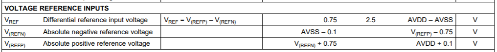

I'm planning to supply 3.0V to AVDD and REF separately.
In that case, there is a possibility that "AVDD < Vref" may occur due to voltage variation of AVDD.
Is it acceptable? If it is acceptable, please tell me how far the voltage difference is possible.
As described in the datasheet, is "AVDD > Vref" mandatory?
By the way, AVSS is 0V.
Kato
  • Hi Kato-san,
    The answer to your question is in the table you provided (section 6.3 of the datasheet). The absolute recommended positive reference voltage is AVDD + 0.1V. The absolute maximum, as given in section 6.1 of the ADS122C04 datasheet, is AVDD + 0.3V.
    Generally you would want a low-noise and stable supply for AVDD as well as the reference, so why not use the same supply for both? In fact, the reference mux allows for just such of a connection (AVDD/AVSS).
