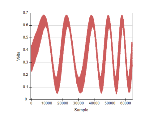

I collected data with decimal number and got that results what does this mean?
I expect results shown like diagram. What should I do

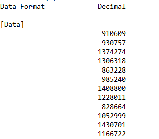

    I mean in data analysis tool, results are shown in graph in time domain tab is what I want to collect, but  in tab data inspector shows results like you see in the picture.
    Data inspector tab shows:
    Graph in time domain shows:
    I want to know how can I convert results in data inspector tab to the results in time domain tab.
    For example, at Count 0 ADC0 shows 910609. What does 910609 mean? I expect 0.xx V or something like that.
    Thanks you!
  • Hi Linh,
    What you're seeing are the output data codes. Multiply 910609 by the size of the LSB and it will yield a voltage value like you are expecting.
