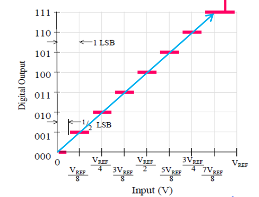

About the ADS8598H's transfer function, in the datasheet just show the  figure.66.
Why PFS-1.5 LSB and NFS+0.5 LSB and 0V+0.5 LSB ?
I want to know how to explain this matter. Thanks!

    An ideal transfer function for a ADC has a transition point at LSB/2 voltage, the steps are designed to have transitions such that the midpoint of each step corresponds to the point on this ideal line. Here is an example:
    Assume an ideal 3 bit ADC with bipolar input range = -4V to 4V:
    FSR = 4-(-4) = 8V
    ADC codes = 2^3 = 8
    LSB size = 1V
    LSB/2 = 0.5V
    If we plot the transfer curve for the above ADC, the transition points will be as per table below.
    As you can notice, at NFS the region is (NFS+0.5LSB) and at PFS this is (PFS-1.5LSB)

    Another example for unipolar input ADC shown as below, the first transition happens at 1/2 LSB, and the last transition happens at Vref-1.5LSB (Full scale range is Vref).
    Hopefully this is helpful for you to understand, thanks.
