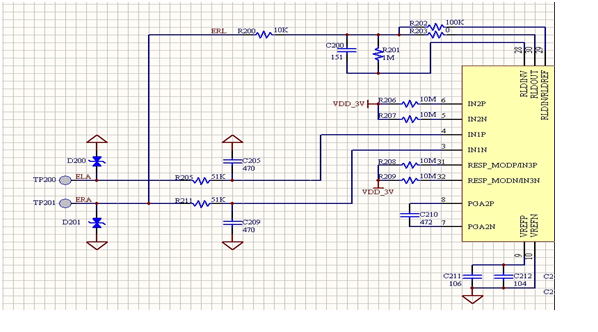

  1. When 1P and 1N (3PIN, 4PIN) of the ADS1291 add series resistances and identification instrument input 5mV sine wave, the value of sine waves obtained from the ECG acquisition will seriously exceed the amplitude.If a small DC component is added to the sine wave of the identification instrument, the sine wave will appear normal; However,adding a DC component directly to the circuit will not work. What is the cause of this?

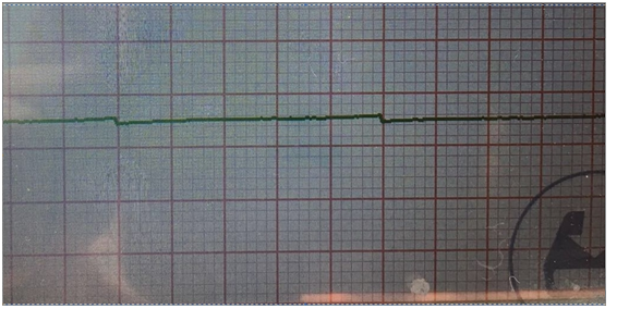

b. When 1P and 1N (3PIN, 4PIN) of the ADS1291 have capacitances and resistances in series,the value of sine waves is 5 mV and normal,which is read from the identification instrument.However, when collecting or shorting between R and L leads, there is a small protrusion on the ECG line,as shown below. Could you please tell me how to solve the problem of one second fluctuation of capacitance? And what is the reason for this?

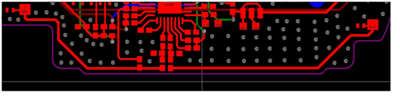

I am also in accordance with the recommended figure to debug, the same phenomenon, PCB line is no problem

    Remember that each input signal should be centered around the same mid-supply common mode voltage. Right now, you show a 10k pull-up resistor to RLDOUT on IN1N. What is the common-mode of IN1P?

    1) What do you mean by seriously exceed the amplitude? Do you mean that the wave is larger than the input sine wave that was applied? Are you measuring this at the input pins of the ADC or the output? What are the gain settings on these channels?
    Since these channels are measured deferentially, the common DC component will be canceled out.
    2) When you say collecting, do you mean reading data? It looks like an inductor is charging and discharging. Perhaps shorting these leads or the introduction of the components are causing the current to lag the voltage resulting in an inductance.

    identification instrument input 5mV sine wave( input),the ECG acquisition will seriously exceed the amplitude(DISPALY),I didn't set gain Settings。

    Did Ryan's answer solve the common mode problem?
    Are you having trouble configuring the gain settings of the device?
    I don't fully understand the issue that you are having. Can you please explain in further detail?
    Is this voltage going to the 1P and 1N (3PIN, 4PIN) of the device? What is the magnitude?
    Are the input pin limitations being exceeded due to the common mode issue?

         RLDOUT  connection   to 1 p, 1N pin is not connected,I also don't connection to RLDOUT, The same phenomenon.

    Look at the picture
    display:
    I set  sine wave 0.3mV, no problem.
    There's no problem in the other waves ,There is sine wave wrong
