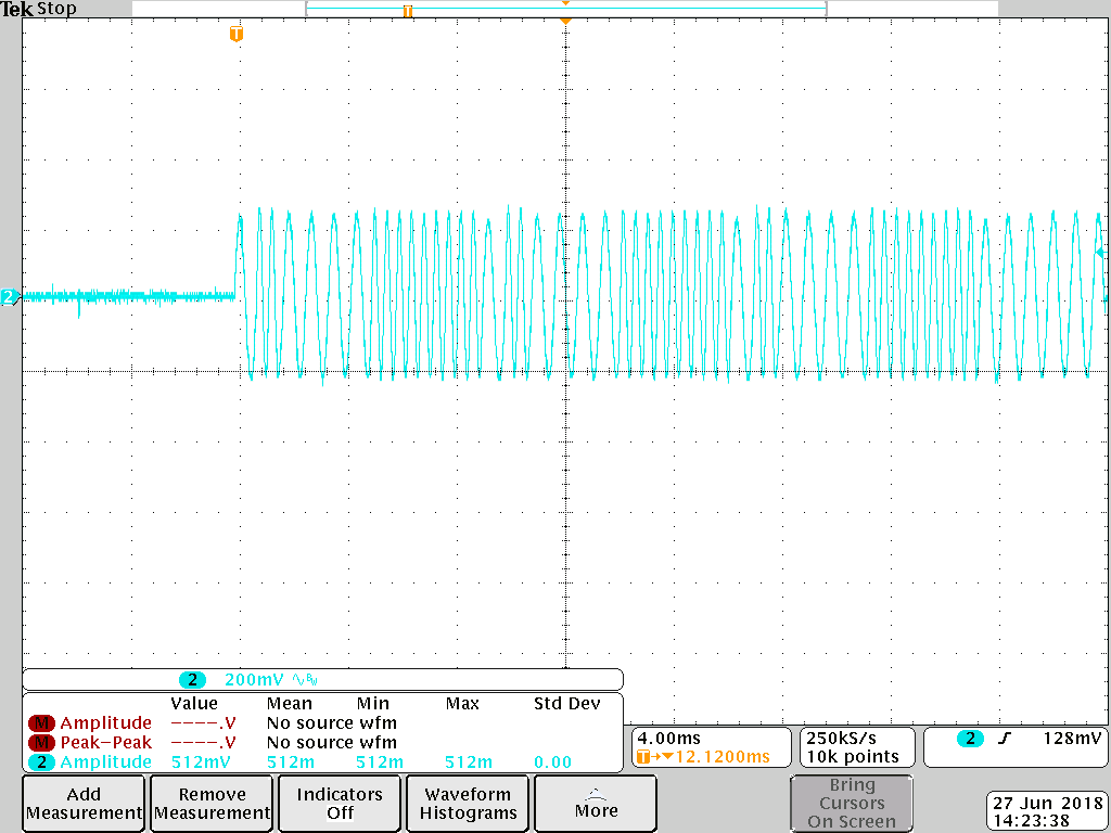

    I looked at your waveforms and in both the "4mA" and "5mA" cases the MODOUT waveform looks like it is unstable. It should be consistent amplitude but in the captures you provided it seems to shift downward. Also, the loop current HART signal looks very noisy and inconsistent which may be due to the issue with MODOUT. When I connected the EVMs I was able to get a clean HART signal onto the loop as you can see in my previous post. Did they switch R11 out for a 500 ohm resistor and switch the capacitors as I described?
    I also noticed they appear to be using a different board than the orderable EVM based on the picture in your previous post. Is this correct? This looks like a pre-release version and I don't have the schematic on hand. The schematic and the jumper settings in the EVM User's Guide will not be correct for this board. I would recommend they use the final version of the EVM which I have linked to below.

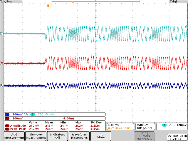

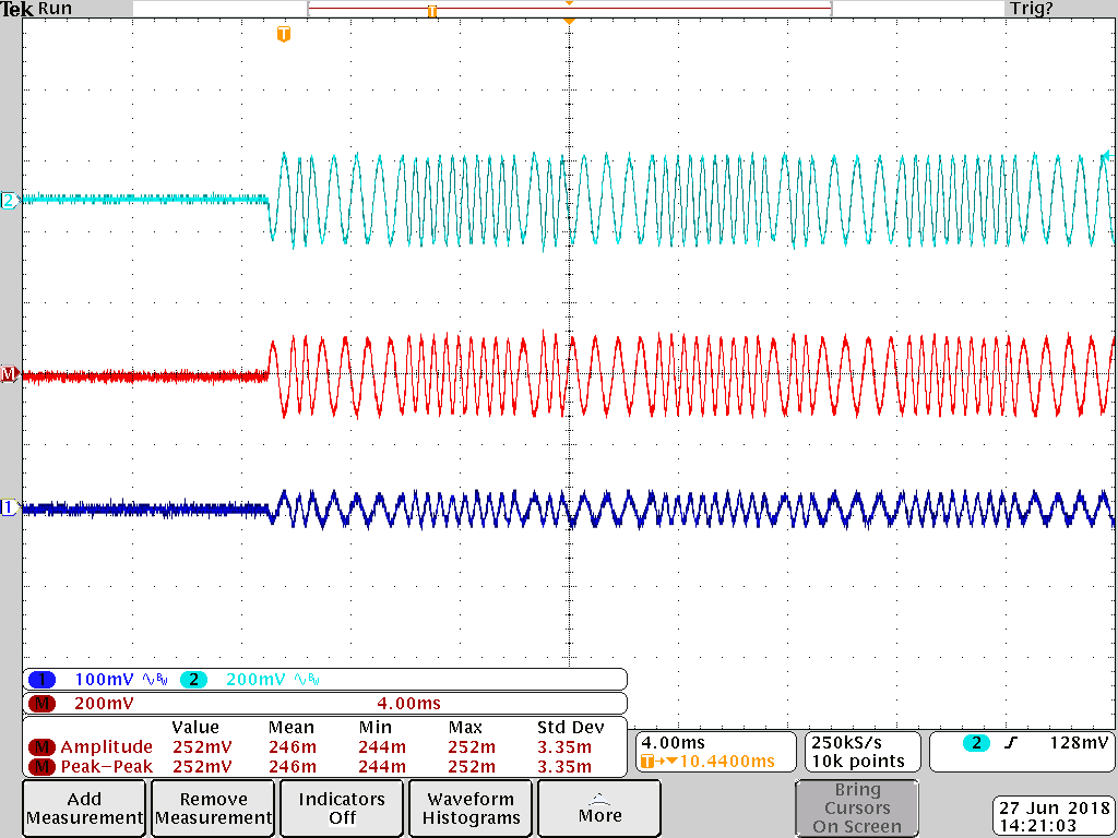

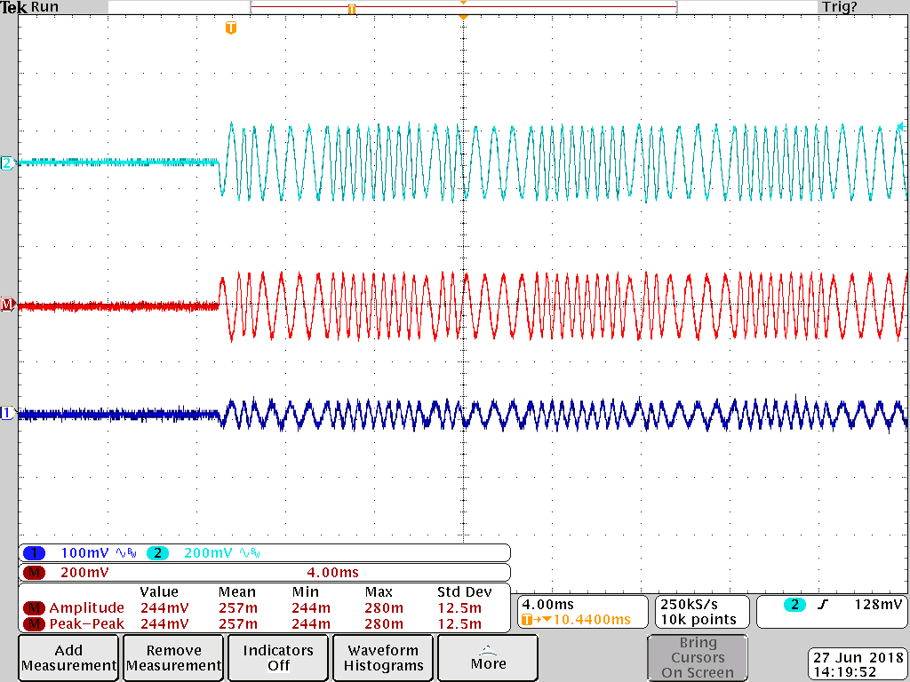

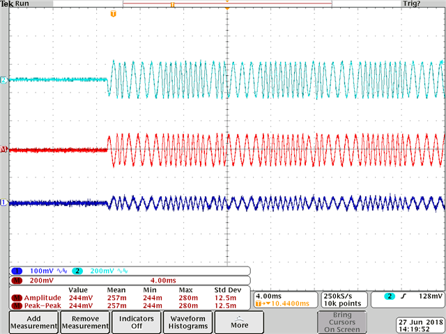

  • Hi Anastasia,
    Understood, I was just checking because the board photo in your previous post is definitely not the final version of the DAC8742H EVM.
    I wanted to ensure that the HART output amplitude does not change when the DC current is at 4mA compared to higher values. I set these boards up as I described in my previous post and took scope captures of the output and the HART input signal from DAC8742H. I confirmed that with how I have connected these two EVMs the output HART amplitude does not change with DAC161S997 DC current value.
    The first capture is with the loop current set to 10mA. The HART signal is the red waveform measured across a ~250ohm resistor.
    The second waveform is with the same HART signal input but the loop current set to 4mA. You can see that the amplitude is around 250mV in both cases.
    The third waveform is the HART input signal from DAC8742H measured at MODOUT while connected to DAC161S997 EVM (500mV pk-pk).
    You can also see that the HART input signal and the loop HART signal are clean waveforms. Even if the loop HART signal has an issue I would expect that the waveform would be fine on MODOUT. In the scope captures you shared the MODOUT signal was not what I would expect and the loop HART signal did not have a constant amplitude in ether the '4mA' case or '5mA' case. There is an issue with the MODOUT signal. Can they provide a capture of MODOUT when disconnected from DAC161S997?
    Garrett
