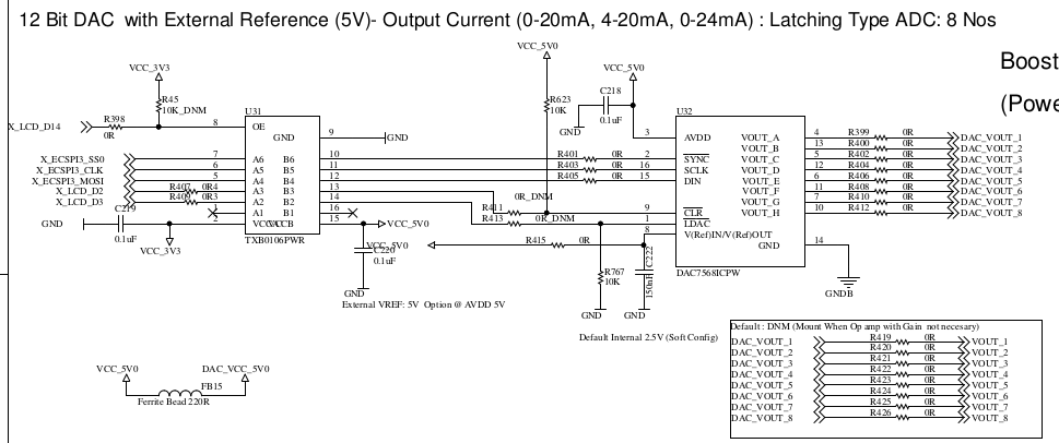

The output gain of my DAC7568C is doubled occasionally.
I have a ADS114S08 device on the same SPI bus. Once I disable the ADS device in my linux dt, the DAC works normally(no double gain issue).
I checked at the spi lines using a oscilloscope and I verified that the data received by DAC is error free.
There exists another DAC7568C on the same board in a different SPI line which works just fine. Only the first DAC has the gain issue.
I have attached a reference test log file of DAC values on automated reboots with different cases. (about 350 reboots)
Note: In the attached log file, the 1.3V is the correct value and the 2.5V is the incorrect value(doubled gain)
Below is my device-tree entry of the SPI bus in which the DAC & ADS reside.

Please find the schematic for reference
