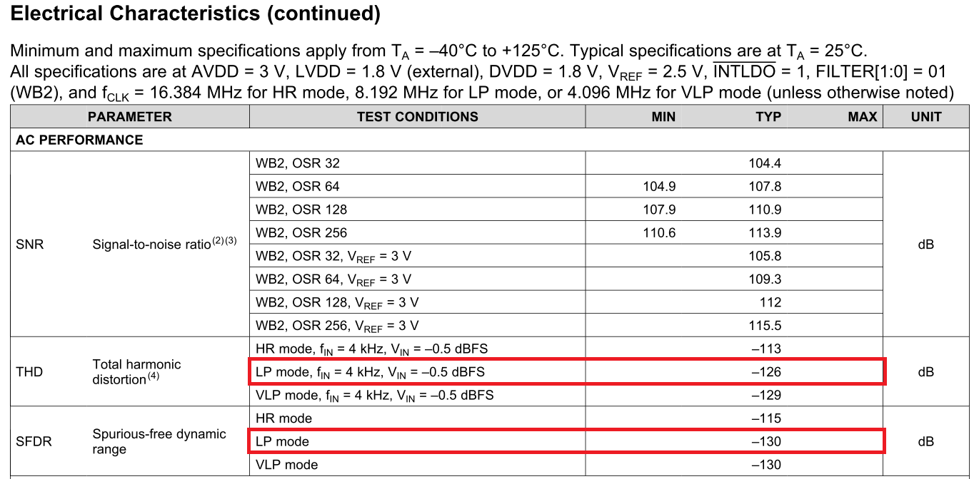

I got a feedback from our customer that 2nd harmonic distortion is higher than one which is mentioned in the data sheet by verifying ADS127L01EVM, so it is approximately -110dB when inputting 1kHz sine wave.
In addition, it doesn't change even if changing the operation mode(the high-resolution/low-power/very-low power modes) and VREF.
Could you please tell me how to improve this issue ?

    He is concerned not only the 2nd harmonic distortion, but also THD, so is my understanding correct that the THD performance improves if setting the LP mode, not the HR mode ?
    If No, could you please tell me that reason in detail since he would expect that the THD performance is less that -120dB if setting the LP mode ?
    In addition, is the THD performance improved greatly if replacing THS4551 with THS4541 ?
    Kato
  • Hi Kato-san,
    I have accepted your friend request.
    Yes, you are correct about the improvement in distortion performance as you change from HR Mode to LP Mode. The reason for this improvement is the input voltage transients produced during sampling have more time to settle. The slower the CLK frequency, the longer the modulator sampling phase (approximately 1/2 the modulator period). With my same EVM setup, I only expect about 110 dB to 115 dB in THD performance at full-scale in HR Mode.
    One of the reasons for the better THD specs in the datasheet is that our characterization team used the THS4520, which is the predecessor to the THS4541. The higher GBW certainly helps the input voltage transients to settle faster. This will improve the linearity of the system and provide better THD results. However, the THS4541 consumes about 7.4x the power that the THS4551 consumes. Therefore, we used the THS4551 on the EVM to show a solution which was comparable to the ADC in terms of both performance and power.

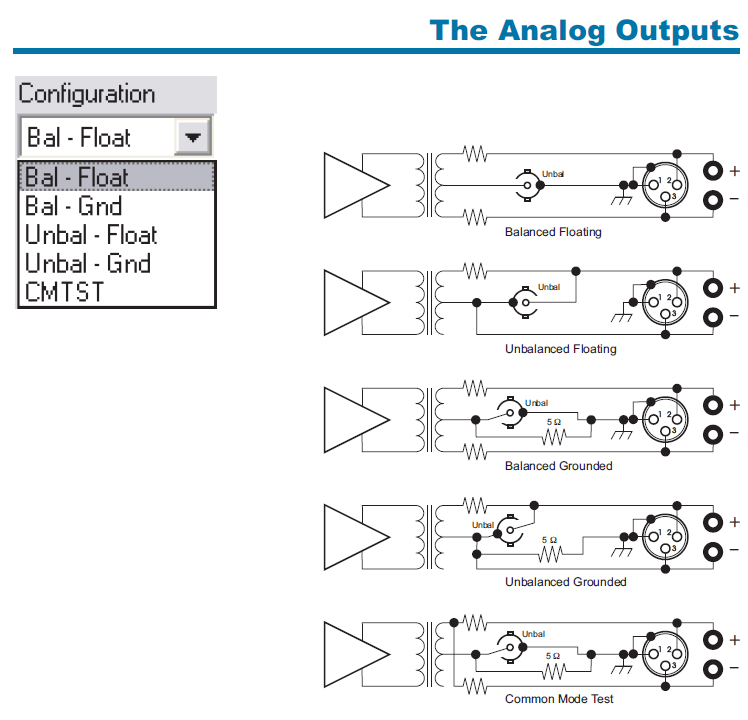

  • Hi Kato-san,
    I have reviewed the data that your customer shared. It does look a little worse than what I was able to measure on my bench with the same EVM.
    After reviewing the APx555 user manual, the APx555 should be able to source a sine wave with the same or better signal integrity than the AP2700, which I am using. A couple potential differences we should discuss are:
    1. Output Configuration: On the AP2700, there are two options for balanced output signals ("balanced grounded" and "balanced floating"). Please see the image below. Sometimes, I find that one setting works significantly better than the other. The difference lies in pin 1 of the XLR connector, which may be set internally to the AP chassis ground, or it may be left floating and tied to the ground of your local PCB (i.e. the ADS127L01EVM). Does the customer have the option to change this setting?
    2. Source Impedance: What is the source impedance setting that the customer is using? I am using 40 ohms, which is the minimum setting.
    AP2700 Output Configurations:
    The data from your customer does not look terrible, but I believe the prominence of the even harmonics may indicate a potential grounding contention between the AP and the EVM.

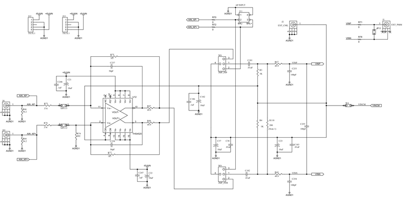

    By the way, could you please provide the schematic for the FFT plot data which is taken with THS4520 if possible ?
    Kato
  • Hello Kato-san,
    Please see attached (note that the ADC previously used a different part number):
    ADS1671_EVM_RevA1.pdf

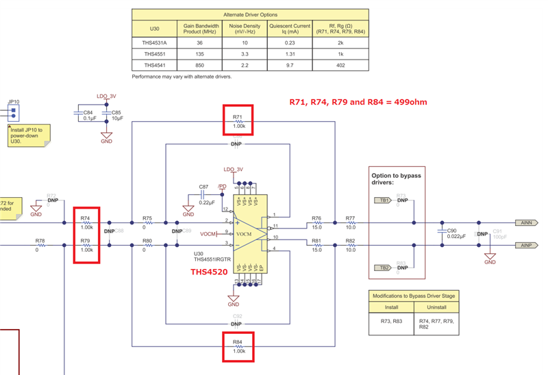

  • Hi Ryan-san,

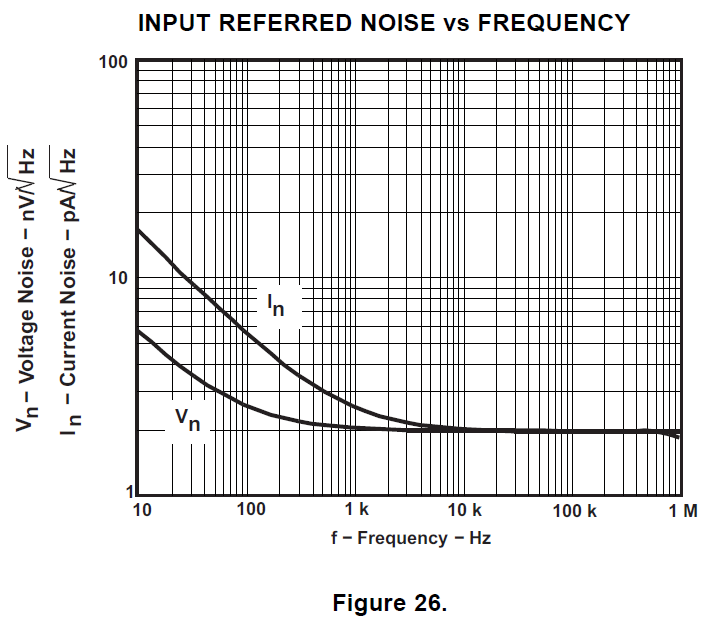

    The THD performance is improved if replacing THS4551 with THS4541, but the 1/f low frequency noise increases slightly.
    So, could you please tell me the value for each resistor if setting the 0dB gain with THS4520 about the following schematic ?
    Unfortunately, there isn't the difference between two options for balanced output signals.
    Kato

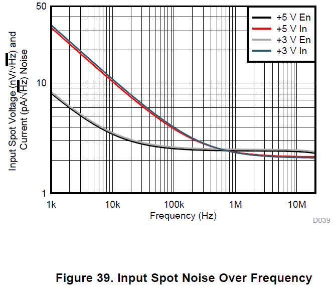

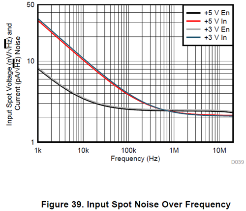

  • Hi Kato-san,
    Most of the circuit diagrams in the THS4541 datasheet use resistor values between 402 ohms and 499 ohms. For our testing with THS4541 on the ADS127L01EVM, we used 499 as the feedback and gain setting resistors. For the THS4520, Table 1 and Table 4 show recommended resistor values for various gain settings. It appears that 499 is an acceptable value for unity gain as well.
    Comparing the noise performance from the device datasheets, I do see that the 1/f noise is much better in the THS4520 than the THS4541:
    THS4520:
    THS4541:
  • Hi Ryan-san,
    Thank you for the information.
    Could you please confirm just in case whether my understanding is correct about the following schematic if applying THS4520 as the ADC driver ?
    I am concerned about whether THD4520 will work stably since it is different with the schematic which is mentioned in THS4520 data sheet.
    Kato
  • Hello Kato-san,
    I'm not completely certain if the circuit you are describing is optimized for stable unity-gain operation. Those four resistors you outlined will be reduced to 499 ohms, like you said. However, I don't know if the THS4520 is stable with only resistive feedback to drive the R-C input filter for the ADC. The FDA may require some compensation components as well, as shown in our characterization board schematic.
    Another suggestion would be to verify this circuit with the high-speed amplifier experts in the High-Speed Amplifiers Forum.
