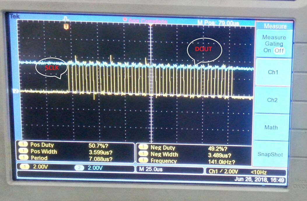

  • Hi Neha,
    Is it possible to capture two consecutive data frames with an oscilloscope? The first should show the NULL command being sent, and the second should show the ADC response. Please probe SCLK, DIN, DOUT.
    Also, how are M0 and M2 configured? If you have Hamming Code enabled, please try disabling it by tying M2 to ground.
  • Hello Ryan,
    M0 & M1 are grounded while M2 is connected with IOVdd pin (i.e. 3.3V Digital). I have sent NULL command (0x000000) at DIN & captured ADC response. I am still receiving 0xffffff at DOUT.
    Kindly check the scope traces & provide me a solution.
    Also check my hardware.
  • Hello Neha,
    Thanks for sharing the scope captures. I understand it may be difficult to capture consecutive frames together (i.e. UNLOCK command + NULL command to see the response). From what I can tell, 0x000000 is written to DIN and you see only 0xFFFFFF on DOUT. If this is consistent with what you see every frame, then there is certainly an issue.
    One thing that I just noticed is that your SCLK does not appear to have a 50/50 duty cycle. Can you verify the SCLK frequency and high/low times for me? They must agree with the Timing Requirements in Table 7.6:
  • Hello Ryan,
    I tried to get 50/50 duty cycle and I got these captures now.
    As you can see it's still responsing 0xFFFFFF.
    Kindly suggest something.

  • Hello Neha,
    I've reread our thread and one detail that I still haven't confirmed with you is whether or not you are toggling the /CS pin between frames. When I say to send UNLOCK "in the first frame" and look for "READY" in the next frame, the /CS pin must be taken high to end the first frame and return low to start the second frame. Otherwise, sending additional SCLKs without toggling /CS will look like one long frame to the part and you will not see the correct response. Please confirm that you are:
    1. Sending the correct number of bits per frame (i.e. [OP-CODE + CRC (if enabled) words] x 24 bits per word).
    2. Toggling /CS at the end of each frame.
    Although the channels are disabled by default upon power-up, you can probe the /DRDY pin to see if it is toggling, even before you send any commands. Can you check the /DRDY pin on the scope after power-up before you communicate with the device?
