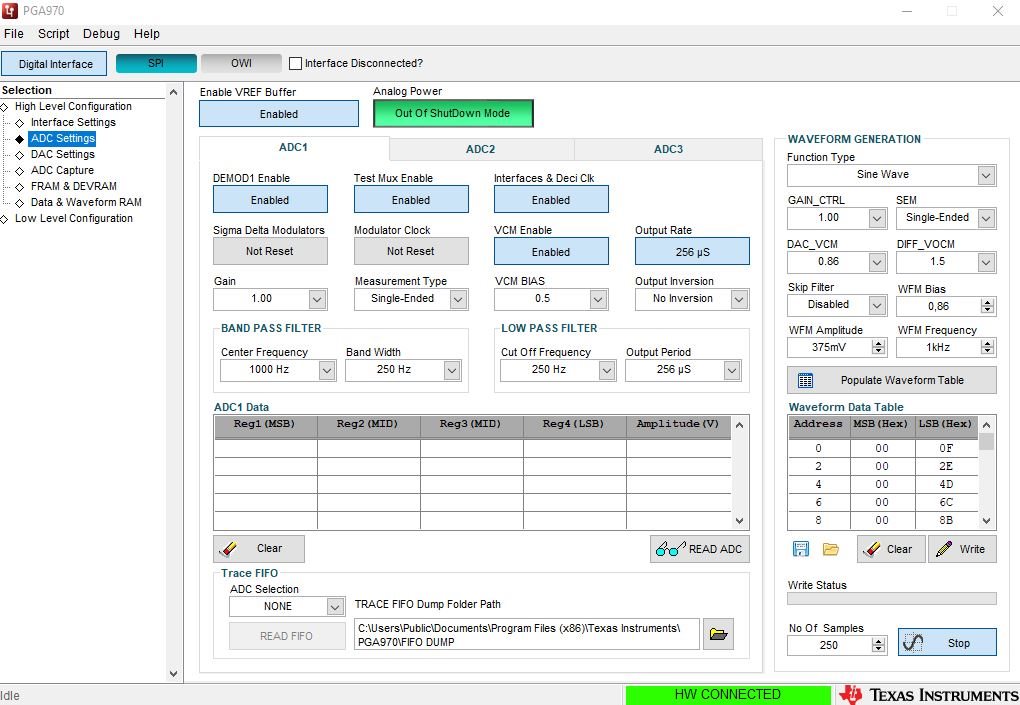

using a PGA970EVM (and USB2ANY) with PGA970GUI for an test application with LVDT.

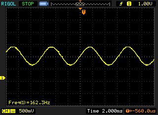

I can config the PGA970EVM with the GUI, but i dont get the correct waveform at generator ouput.
Following the introductions in the datasheet or users guide did not succeed.
In case of 1kHz there are about 150Hz, 5kHz => 700Hz,  10kHz => 1.5kHz at waveform generator output.
All necessary options are enabled, i populate the waveform table and write it to the device before generating the sine wave.
I dont know whats going wrong, would you give me some support?
Thanks!
    Do you have any scope captures of the waveforms that are being generated? Do the sine waves look like sine waves or are they distorted in any way?
  • The sine waves looks OK, just frequency is wrong.  Measuring on Pin P1 without external amplifier.
    GUI settings:
    Regards.
    we ordered a new PGA970EVM board, configured it with GUI and we got the correct waveform at primary side (3V amplitude, 10 kHz).
    After connecting and disconnecting a 3-wire LVDT to the primary and secondary side, we got a frequency error again.
    Again the sine wave looks ok, but frequency is lower than it should be (10 kHz => only 6 kHz at output).
