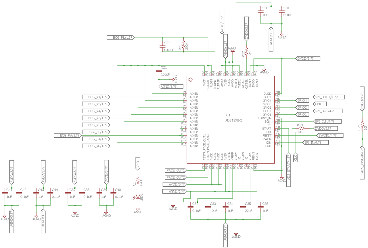

Hello, im doing a mobile application that recieve 12 ECG derivations and graph the 12 derivations.
First, im triyng to read channel 2 and 3 form the ADS and display the data in a graphic, but i have signals that do not look like ECG. I have 2 questions.
1.- The channel 2 and channel 3, have LEAD I and LEAD II.
I am rigth?
2.- can you tell me if my configuration in the registers is the correct?
My configuration:
Register ,   Data
 0x01,        0x86
 0x02,        0x10
0x03,         0xdc
0x04,         0x1d
0x05,         0x81
0x06,         0x00
0x07,         0x00
0x08,         0x81
0x09,         0x81
0x0a,         0x81
0x0b,         0x81
0x0c,         0x81
0x0f,          0xff
