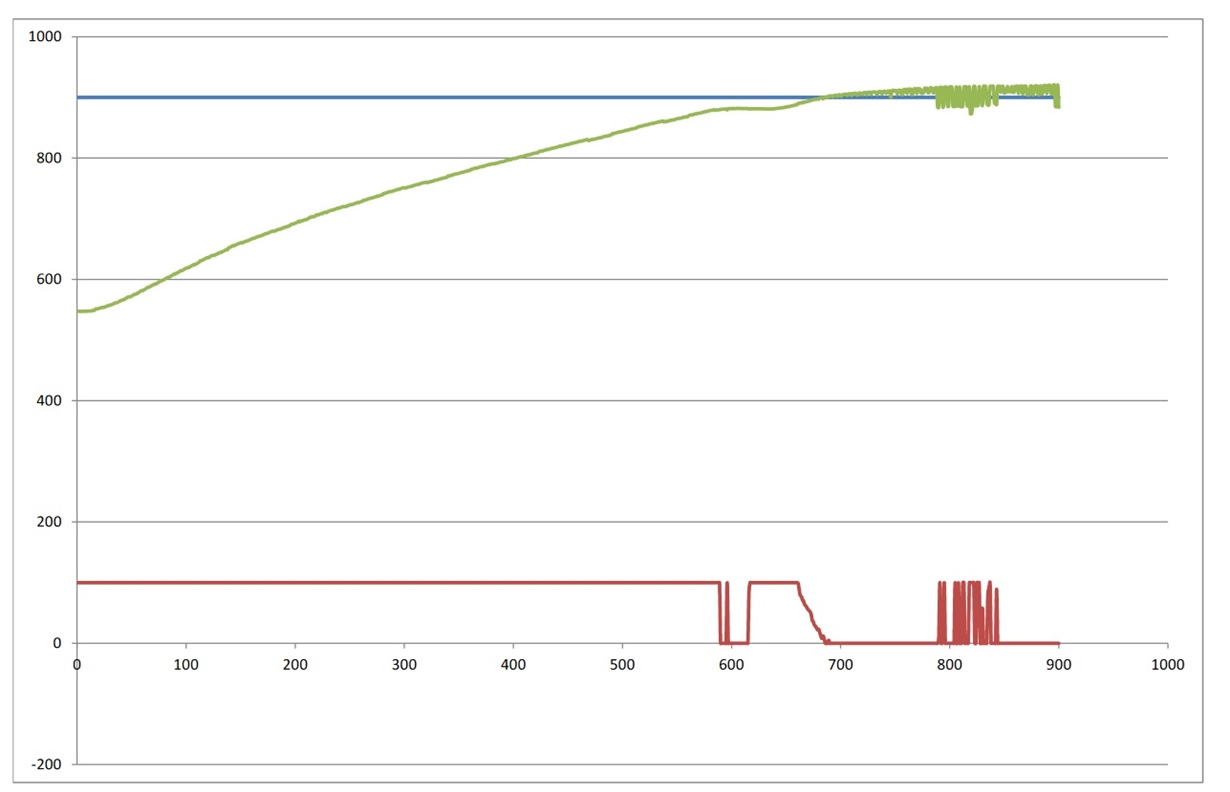

Temperature graph:
- The green line is a temperature graph as seen by the ADS1148 chip

    First, it would help to have the raw data that you have in the plot. I don't want the converted data reported in °C, but rather the output code from the ADC. I'd want the reading for both the thermocouple and the cold junction measurement.
    Second, it would be good to have a schematic to work from. I'd like to know how you're biasing the thermocouple and how you make your cold junction measurement from the thermistor. I need more information about your setup, maybe with an explanation of how you setup the measurment, what the
    Looking at the output data plot, it looks like your green line has some sort of alternating error. The data looks like it has values going back and forth by about 40°C. My first guess is that this is some sort of SPI read error, but I'd need more information to be sure. If the error comes from a bad SPI read, is the device in SDATAC mode, while you use the RDATA command to read data?
    You mention that the data is also off by 100°C, I'm not sure if this is part of the alternating temperature read error or if this is some sort of systemic error.
