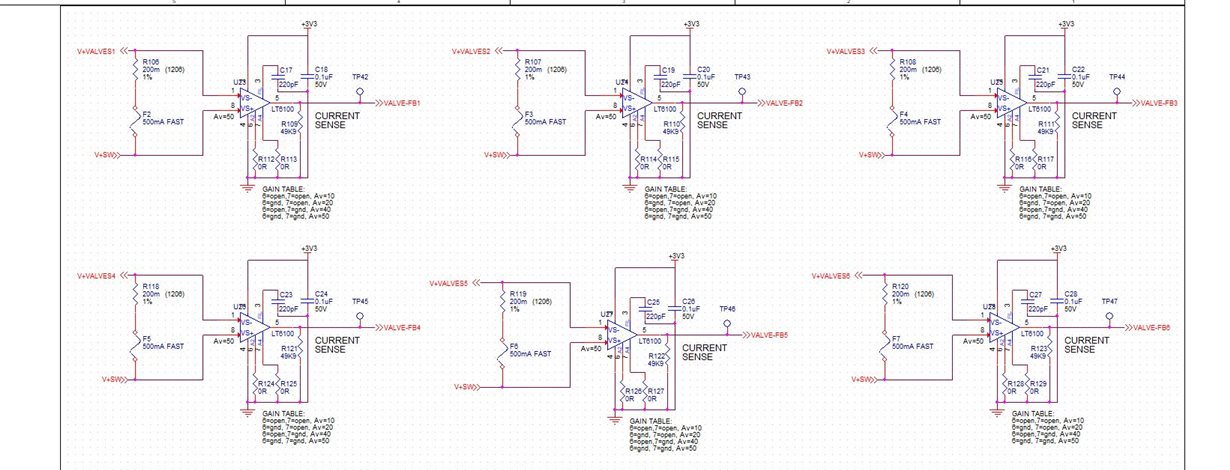

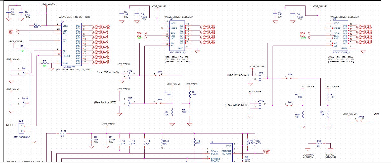

I am using ADC128D818 to read feedback of my loads current. I am able to communicate with the device, the reading I am getting does not make sense. Could some one able to see my setup commands make suggestions
