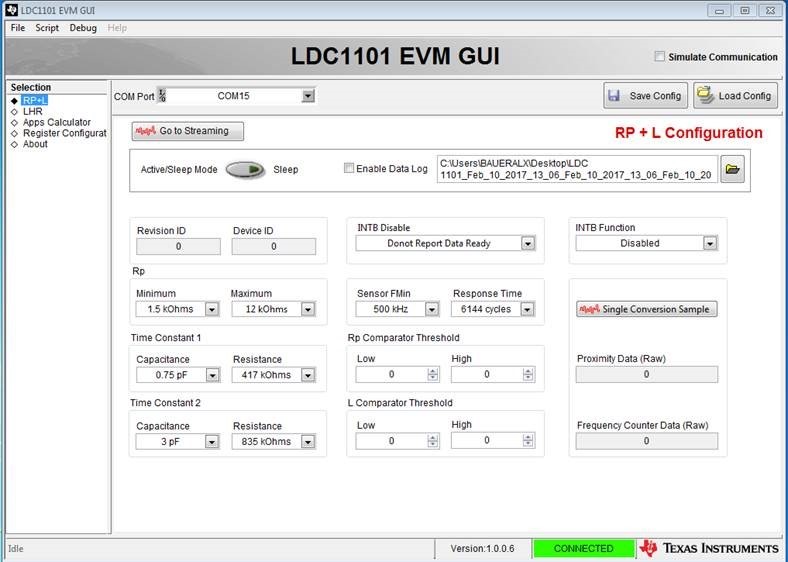

  • Hi Kristin, hello TI-Support,
    attached you can find pictures showing the Setup used with the GUI.
    First three pictures show the settings and the corresponding Rp and Proximity results offered by the GUI.
    If we change the RpMIN setting to 0.75kOhm no Rp is shown by the GUI only Proximity readings are shown - can you please explain that behaviour, too?
    Meanwhile we measured the Rp as described in chapter 4 of your document "SNOA936–October 2015-Measuring R p of an L-C Sensor for Inductive Sensing" and received a value of 4.9 kOhm.

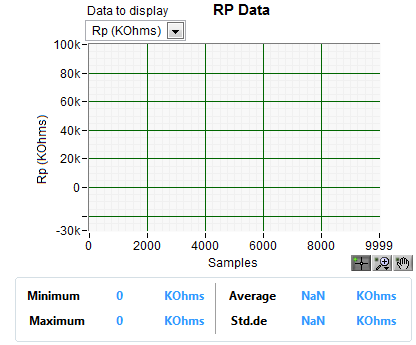

    e.g.
    • Rpmax=6kOhm and Rpmin=0.75 show no Rp Signal
    • Rpmax=6kOhm and Rpmin=1.5 to 3kOhm show a RP signal
    • Rpmax=6kOhm and Rpmin>3kOhm show a RP signal corresponding to Rpmin.
    "no graph displayed" shows following RP-Display:
    "0" shows following RP-Display:

  • Hi Frank,
    The Time Constant settings configure internal time constants necessary to keep the sensor oscillating correctly, based on the sensor frequency. Time Constant 2 is a function of RP_MIN. You can read more about them in section 8.4.2.2 in the datasheet. Page 20 of the LDC1101EVM user's guide has a table that includes recommended time constants for the EVM. If you have modified them, I would suggest returning them to the recommended values. This could cause issues with the Rp measurements.
    For the most part, your GUI actually looks like it is behaving correctly. If the Rp range does not include the true Rp value, the data registers will return 0, which forces the Rp reading to RP_MIN (based on equation 4 in the datasheet). This will also occur if RP_MIN >= RP_MAX. RP_MAX should always be at least two settings greater than RP_MIN. This explains all of the behavior you've seen except for the first row and first column in Rp-Display. If you've changed the time constant settings, they could be set such that 0.75 KOhms is an invalid setting for both RP_MIN and RP_MAX. Try reverting them to the recommended values and seeing if that helps.
    Finally, I measured the Rp value of my EVM coil on an impedance analyzer. I measured 5.6 KOhms at 3 MHz. I checked with some of our engineers, and it turns out that the default coil was changed at some point. Rp measurements are sensitive to temperature, as well as the capacitive effects of nearby ground planes (or other electric fields). I think that your EVM is functioning correctly and your Rp measurements are within a normal range. I'll update the user's guide with the correct coil parameters as soon as I am able.
