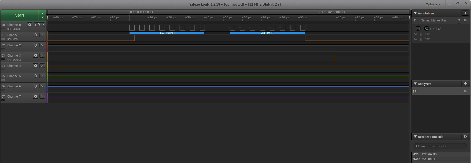

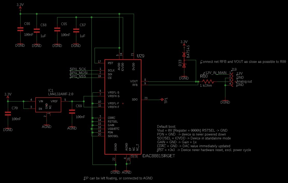

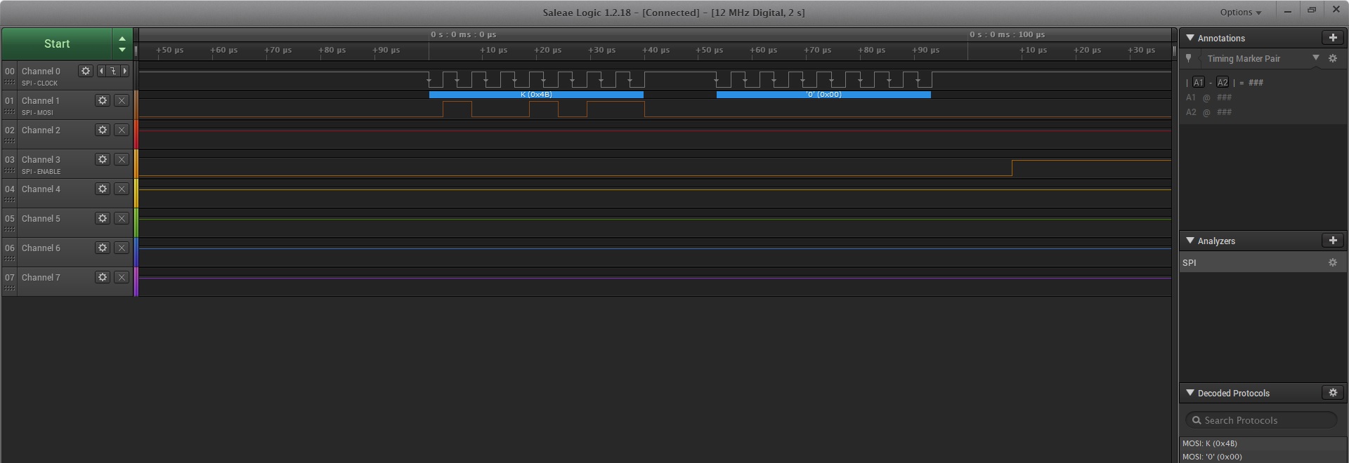

    I don't see the SPI configuration in your code snippet. Can you describe the clock phase and clock polarity settings you have configured the SPI bus with? Also the clock frequency? Even better would be to see oscilloscope captures of an SPI transaction on the bus (ideally just one frame so the resolution is sufficient to see details concerning the digital signals integrity).
    I know you have described the hardware in text, but most ideal would be to see a schematic since in the end this is most directly representative of the hardware. I think I'm less likely to miss a detail if reviewing the schematic directly. Being that the device seems mostly function I somewhat doubt this is a schematic issue.

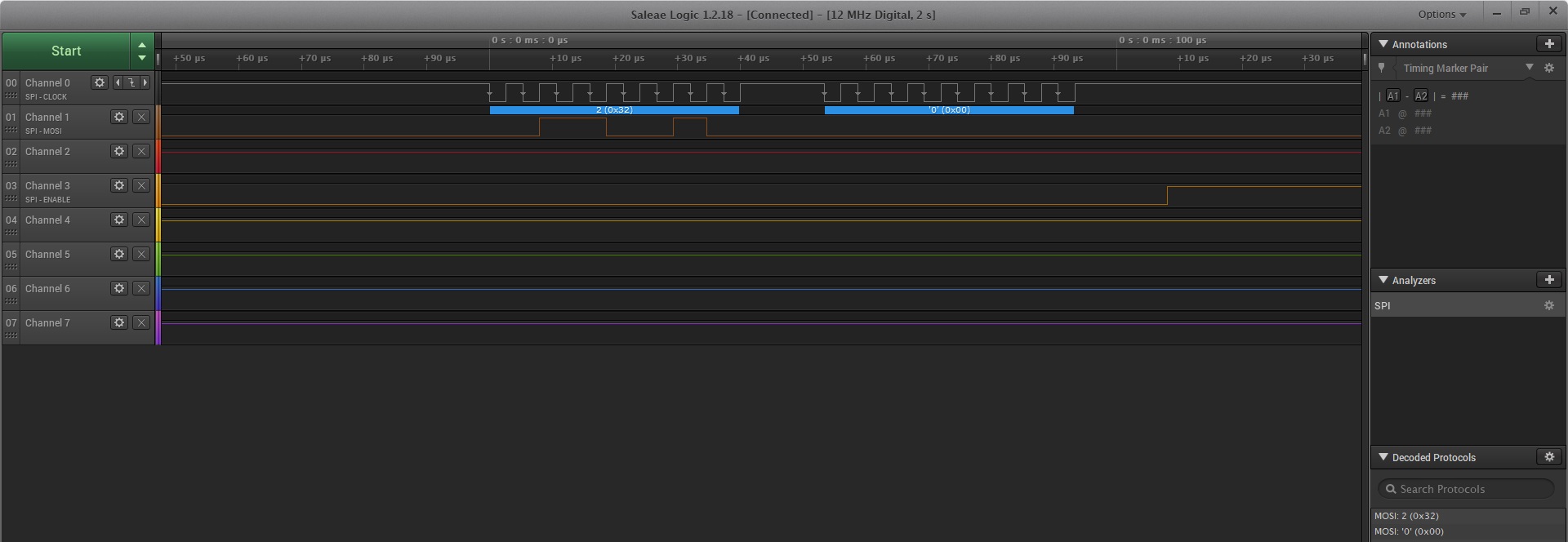

    schematic:
    Logic analyser screen of command: 1.024V 0x7FFF
    Logic analyser screen of command: 0.6V 0x4B00
    Logic analyser screen of command: 0.4V 0x3200
  • Goodday Kevin Duke,
    I already found the solution. One part of your reply made me test the clock polarity settings. I changed it from the (Default) HIGH to LOW and now the DAC works like a charm.
    I knew it would be something small and stupid causing the problem, your reply helped to point me in the right direction.
    Thank you, and have a nice day!
