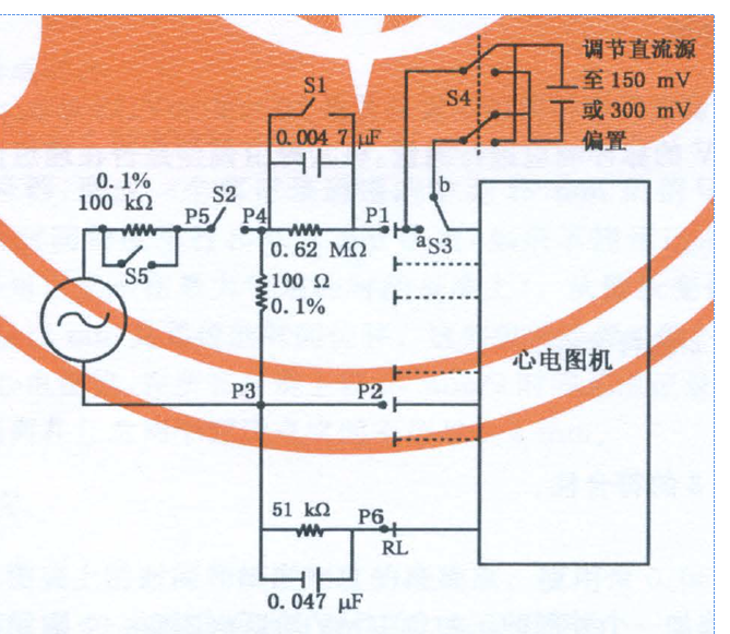

I am now using ADS1298IPAGR for ECG projects~And now we need to pass the test according to YY1139-2013。But now we fail the test,and really really need your help:
Test condition/Method:
  •  Condition: Connect a parallel RC network 620k || 4.7nF in series with tested electrode,The idea is to compare the voltage level with and without series impedance. The difference must be less then 20% to pass the test.The test signal  frequency 0.5H/10Hz/20Hz/100Hz.~~Here is the test circuit:
  • Method:①ECG diagnosis equipment powers on,set the gain to 10mm/mV ②close S1&S2,set S3 to a, those used leads connet to P1 and P2, unused leads connect to P6,then regulate the sinusoidal signal generator to a 1Hz,20mm(peak-to-valley value) signal   ③then disconnect S1,measure the change of amplitude.In the stable state,the change must be less then 20%.  ④ Then use 0.5Hz,10Hz,20Hz,100Hz,and repeat step ①&②, The output amplitude's difference( disconnect S1 compared with  connect S1)  should be less then 20%.
Test results:

From the test resuts,0.5Hz/10Hz/20Hz can pass the test in all conditions,but 100Hz cannot pass the test in any conditon~
Bisides, I have tested the EVM: ADS1298R, and test result is as followed:
100Hz 2mV signal,when the S1 is connected,the result is 1,91mV,and when the S1 is disconnected,the result is 1.96mV.
It means when external circuits is added,the peak-to peak value becomes larger. Compared with the original signal,their is distortion~

  • Hello Fawn,
    Thank you for your post.
    Why do you say that your system fails the test at 100 Hz? The worst result that you show is 17 / 20 = 85%, which is greater than the passing criteria of 80%.
    Multiple factors, including noise coupling, filter frequency response, and sampling rates will affect the magnitude of the signal you measure at the ADC output. Leave R47, R48, C45, and C46 installed. Remove R49 and R50. These components should not affect the input impedance measurement.
    Please continue to monitor the original thread for updates. We understand the application issue that you are all trying to pass and I believe the same feedback will help everyone conducting the same test. We know that the input impedance of the ADS1298R is more than sufficient - with resistor lead-off enabled, the input impedance of 10M will still preserve approximately 94% of the input signal when forming a resistor divider with a series 620k. Current lead-off mode increases this impedance to 500M and preserves 99.88% of the input signal. The remaining factors that must be accounted for are input signal conditioning, digital filtering, and sufficient sampling rate.

    Our requirements are much higher than 20%~
    We have to  design according to 50M input impedance, requiring attenuation within 2%~

    I am a manufacturer that needs to solve the 50M input impedance. As Fawn said, we need to pass the 50M input impedance test. From the test results provided by Fawn, the amplitude is almost no attenuation at 0.5HZ, 100.5HZ, 200.5HZ, and the attenuation suddenly becomes larger at 100HZ. This is what we doubt. Also for the three factors you mentioned in the reply:
    How much is needed for a sufficient sampling rate?
    All digital filtering has been turned off in our test
    The input signal is a problem that bothers us, because from the spectrum analysis, the signal source we purchased can't get a relatively pure output signal. What advice do you have for the input signal?
    In addition, 1298 nominal 500M input impedance, what is your test method, how to test?
