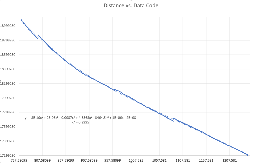

I'm using the LDC1612, attached to the TMS320F28069M C2000 MC. Over the current range I'm running my test using the LDC1612, I need to adjust the DRIVE_CURRENT_CH1 register twice to avoid getting data error codes.
Simple enough, when the DATA_MSB_CH1 register returns an error code, I adjust the DRIVE_CURRENT_CH1 register to one value lower, which fixes the error code. My problem is that when I do this the data resulting from DATA_MSB_CH1 and DATA_MSB_CH0 returns large discontinuities that make mapping the output codes to a distance quite difficult. Here's a graph of this problem (so it is more evident): \
The two discontinuities are fairly evident, but they occur at ~1075 and ~775 microns.
So my question is fairly simple, how do I avoid this type of problem? I take approximately 50 samples for each report, so it is not simply a single weird data code. But I assume I do need to adjust the drive current to avoid damaging the sensor with voltages that are too high. Yet I'd like to avoid these jumps.
Thanks in advanced!
  • Hi Collin,
    You should be able to set your drive current such that the sensor oscillation voltages are within spec for the entire range of your target movement, which would avoid the discontinuity issue. The amplitude can range between 1.2-1.8V, which should be plenty of range for target movement in microns.
  • Thanks for the information. I was doing this, except that my coil was proportionally too large for the distance I was measuring. This was resulting in me having to automatically adjust the drive current registers to avoid amplitude errors. By switching to a smaller coil, I do not need to do this anymore.
