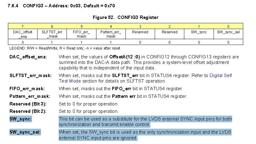

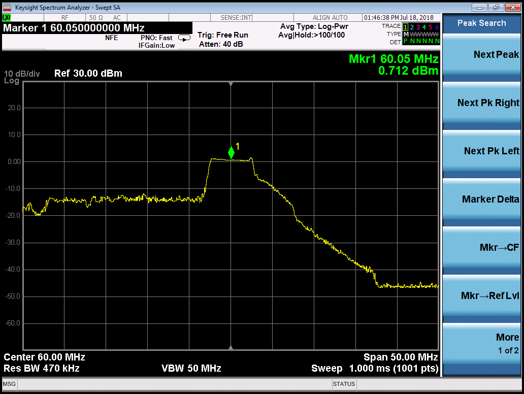

I am using DAC5681z with sampling clock=250Mhz without any interpolation and generating 60Mhz LFM waveform with 5 Mhz bandwidth

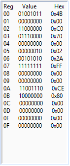

register configuration is as follows

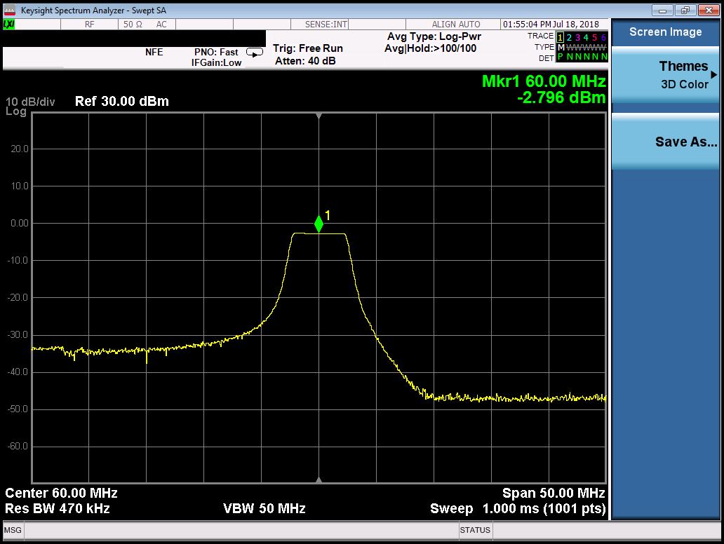

* I am able to get correct output for LFM waveform with single PRF and a single bandwidth of 5Mhz

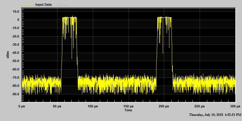

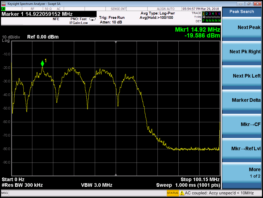

*I am not able to get proper output for different PRF together(one after another) for same 60Mhz LFM with a single bandwidth of 5 Mhz
spectrum is with spurious
time domain waveform :pulses are distorted
please give feedback and registers are correct or not
