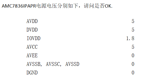

My customer wants to use the AMC7836, and below is the power they want.

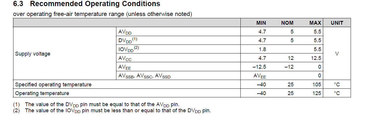

But in the datasheet, the recommend power is as below:
So I am not very sure if I can supply AVCC=5 and AVEE=0.
Or if I use the AVCC=5 and AVEE=0, which performance will be limited?

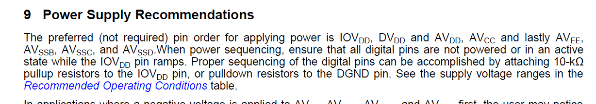

2. For the power sequence, the recommend sequence in datasheet is as below:
So it means the firstly is the IOVdd, but can I supply the DVdd, AVdd and AVcc at the same time because they are all 5V.
or must need DVdd first and then AVdd and then AVcc?
