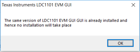

I installed snoc032 installation package for LDC 1101 EVM but since the software was not able to detect the COM port, it was uninstalled. When i try to install it again, i am getting the following error:
Please provide feedback. Thanks in advance!!

  • Hi Sharma,
    When you uninstalled the LDC1101 GUI, did you run the program titled "uninstall.exe" in the C:/Program Files (x86)/Texas Instruments/LDC1101 EVM GUI folder? If not, the GUI may not have properly uninstalled. I would suggest running this program before attempting to reinstall the GUI. In addition, if you are having problems with the GUI not detecting the COM port, ensure that you have NI-VISA Run-Time installed.
