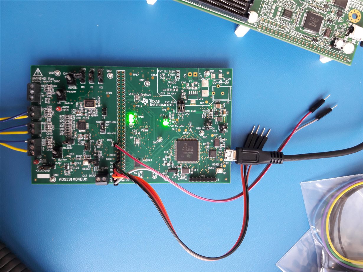

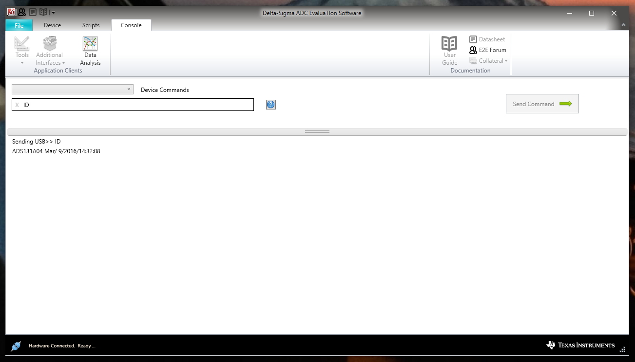

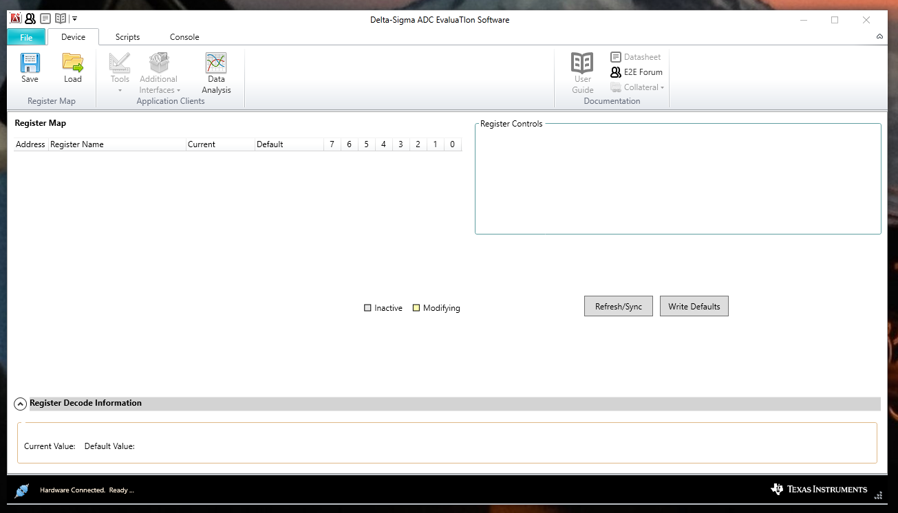

I have an issue with the ADS131A04 evaluation software, irt's stuck in a strange state where the device is identified but nothing else work.
See the attached images for more details.

    Did you install both the Delta-Sigma EvaluaTIon Software and the ADS131A04EVM Device Package?
    If you have both installed and you still have this issue, there are two things you can try:
    1. In the GUI, under File -> Options, check the User Directory and make sure it is pointing to the folder that contains the EVM device package files. By default, it should be under: "C:\Users\...\Documents\DSEvalSW."
    2. Depending on your user privileges or certain security software, we've found that customers generally have an easier time if they run the installers for the GUI and Device Package as an administrator. Try uninstalling both, and then reinstall each one as an administrator, if you can.
  • I forgot the device package.
