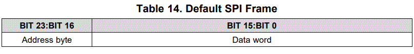

  • - How to fill the value into register since data is 24bits and register is 15bits?

    The most significant 8 bits represent the address of the register being written to. The lower 16 bits are the register data.
    Have they tried reading back the registers they have written to ensure they are correct? This is accomplished by writing to address 0x02 with the lower 6 bits in the data word representing the register to read described in Table 17 of the datasheet. Refer to section 8.5.1.3 of the datasheet for all the details on the read operation.
