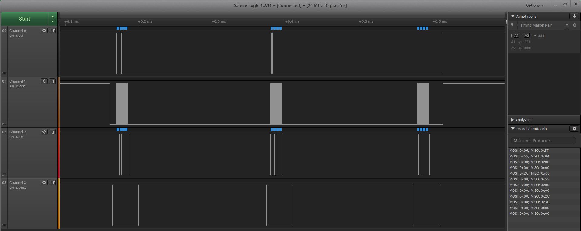

The following image shows the data captured by a logic analyzer, for a Software Reset (0x0011).
As can be seen, the ADC STATUS RESPONSE starts with 0xFF04, indicating the ADC is ready. But I would expect a further READY (0xFF04) response after several SPI cloclcks / Data Frames, as indicated in section 9.5.3.2 (page 50). I clocked in/out 8 Data Frames (each consisting of 32 Bit). The first 32 Bit is 0x00110000, the remaining Commands are the NULL command (0x00).

    Let me clarify a couple things to get started. First, as you found, there are only four commands that can be sent while the device is in a locked state upon power-up: UNLOCK, NULL, RREG, and RREGS. The RESET command (0011h) cannot be used during the initial power-up sequence.
    Second, the beginning and end of a frame is only marked by a transition on /CS. Each word in the frame must consist of the number of bits specified by the M1 setting. The device powers up in Dynamic-Frame Mode with CRC disabled, so the first frame only needs to consist of one, 32-bit word.
    The Command Status Response is located in the first word in the next frame (i.e. after /CS is taken high and returned low). The response to the NULL command will always be the register contents in the STAT_1 register.

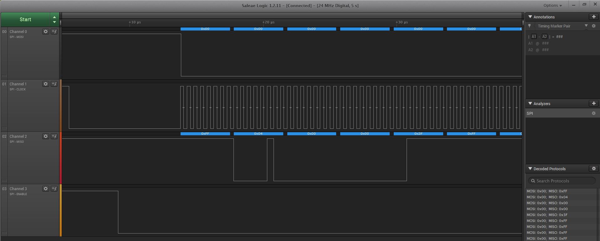

    I performed a SPI communication consisting of an UNLOCK Command (0x0655), a single register read RREG of register 0x0C (-> 0x2C) followed by a NULL command (0x00). The result without a /CS transition at the end of the Data Frame can be seen here:
    As can be seen, the result doesn't looks as hoped-for (0xFF04; 0x0655; 0x2C3C).
    The correct result determined by an additional /CS transition at the end of a Data Frame can be seen here:
    The correct MISO readings can be seen in the right lower corner, resulting in 0xFF04; 0x0655; 0x2C3C. Where 0x3C (of the last Data Frame) is the default register setting of register 0x0C (wgich is read by the command 0x2C).
