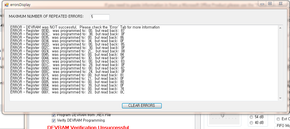

but I fail to download a Hax file which was made by DEVRAM folder's project of "PGA450Q1EVM-S UART-LIN Demo Rev.2.7" to DEVRAM
What is the reason to fail?
Please refer the attached picture

  • Hi WonGeun,
    If you first programmed the HEX file from the OTP folder, then the device is programmed to always run from OTP, meaning you are unable to subsequently load the DEVRAM's HEX file. This is why your errorDisplay shows that the OTP memory space is programmed with non-zero values.
    If your intention is to enable the EVM-S to run from DEVRAM, then you should have first programmed the device using the GUI's DEVRAM tab, and check "Program OTP Memory Also" for the first-time programming while VP_OTP=8V. After this first-time DEVRAM program with OTP, you can disconnect 8V from VP_OTP, and are no longer required to check the "Program OTP Memory Also" checkbox for future DEVRAM re-programming.
    When the "Program OTP Memory Also" is checked, only the first four bytes of OTP are programmed for the device to long-jump to DEVRAM memory to run its code.
