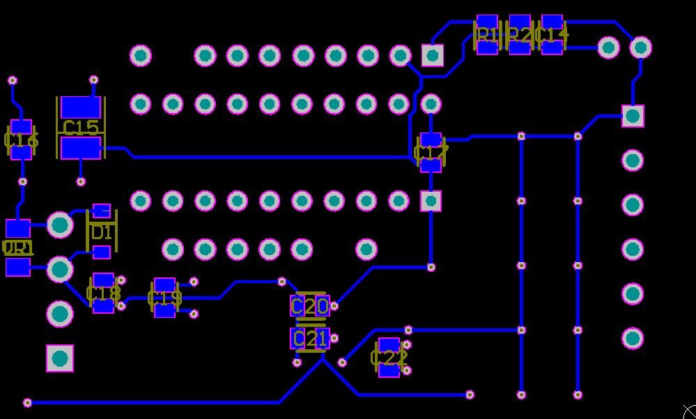

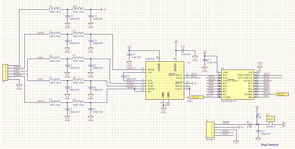

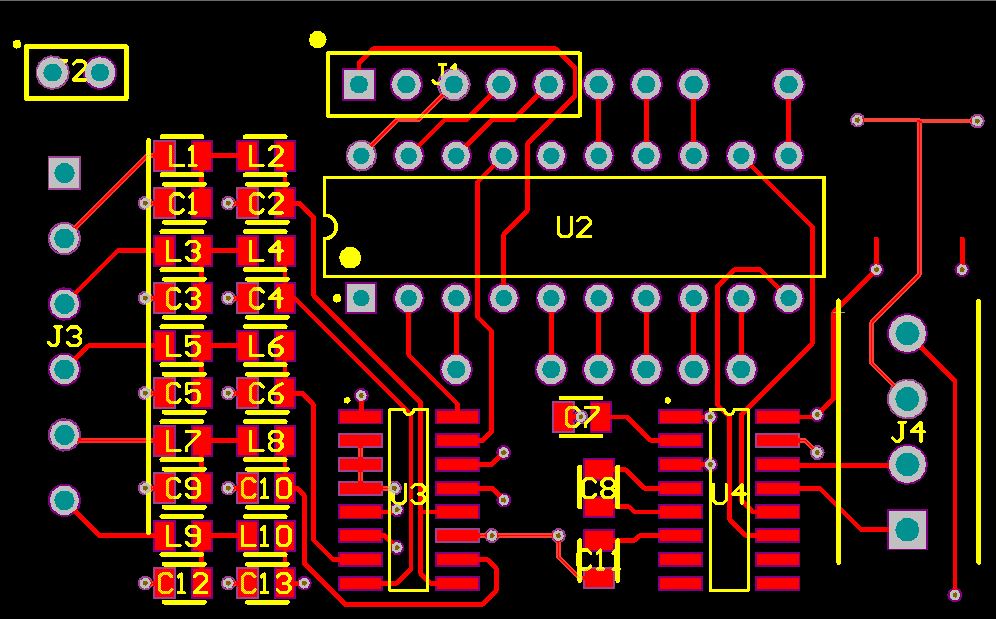

  • Dear Bob, thank you for your support.
    Here below the electrical scheme I'm using
    And here below the top and bottom of the PCB
    Here below the PCB
    I tried to exchange the IC but nothing changes.
    If you note something wrong, please tell me.
    Thank you for your support

    There are a number of general comments I can make regarding your circuit and PCB layout, but let's start with the issue with DRDY\DOUT. Valid data refers to the conversion has completed and the results read from the ADS1231 are correct for the input to the device. If you attempt to read data while DRDY\DOUT is high, the data is invalid for the conversion that is in process.
    As far as DRDY\DOUT never going low, this may be due to your device configuration. If you look at Figure 22 on page 15 of the ADS1231 datasheet, you will notice that PDWN must stay low for at least 10us after AVDD and DVDD are at the nominal voltage. In your schematic you show PDWN tied high to the supply. The ADS1231 requires that for proper startup, the PDWN pin should remain low for the required amount of time. The best way to accomplish this task is to use a GPIO on the micro to hold the pin low until the proper time has elapsed. Also, you can reset the device by pulsing the PDWN pin from the micro.
    Regarding your circuit, you use a lot of ferrites as pi type networks but no resistors. To create a good anti-aliasing filter you should use a resistor in your analog input path. For example replace L4 and L6 with resistors. C4 and C6 are quite large so you may want to reduce them if you use resistors. You should also have a differential cap between the analog inputs that is 10x larger in value than the common-mode caps (C4 and C6).
    To help reduce overall noise, it is best to use a ground plane area as opposed to just ground traces.
    I would suggest fixing the PDWN pin first, then analyze your data. Implement other changes as needed to correct any other possible issues mentioned above.
