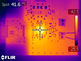

    I agree with your power dissipation and temperature estimates. I have provided a thermal image of DAC8760 EVM driving a 250Ohm load at 20mA with a 24V supply. This was at room temperature and you can see around a 17C rise which agrees with calculation. PCB parameters and enclosures can greatly affect the thermal resistance.
