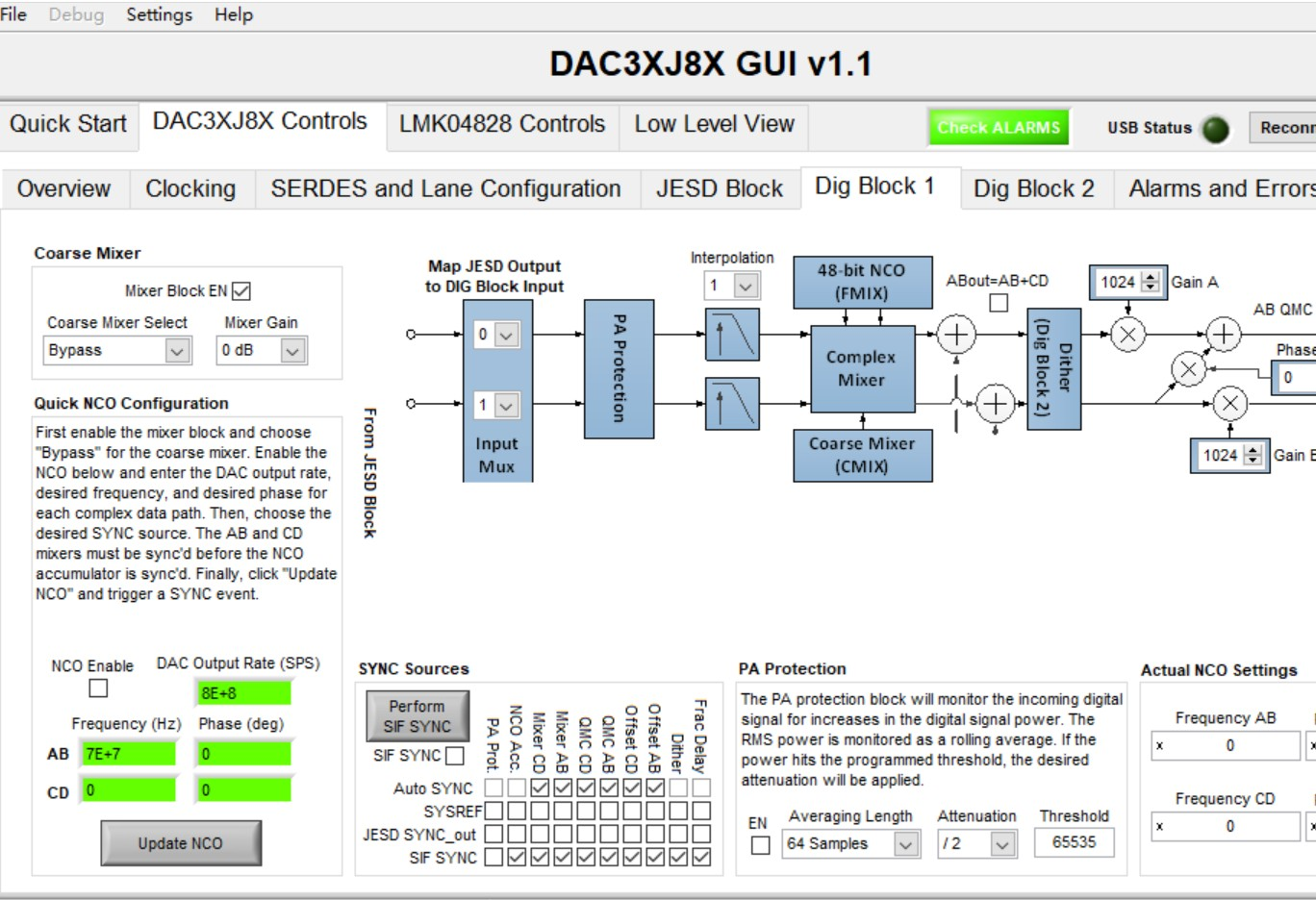

I configured 8 lanes 800Msps.
How to configure the waveform with NCO?For example, if I want to output 70M, is there an example?

1.Can you send the configuration register, About the nco output 70 m or other output,800MSPS.or400MSPS.
2.How to use altear jesd204b, 8 lane output arbitrary waveform 38 j82 register configuration?And altera jesd204b frame format

DAC38J82_Ext_Clk_70M_NCO.cfgUser,
The NCO cnfig file is attached. Please provide more info regarding questions #2. Are you asking for how to set up the DAC to be used as an arbitrary waveform generator with the DAC using 8 lanes? The document I sent you earlier should help explain the Altera frame format. If you need example firmware code, you can download it under the TSW14J56EVM product folder on the TI website.
