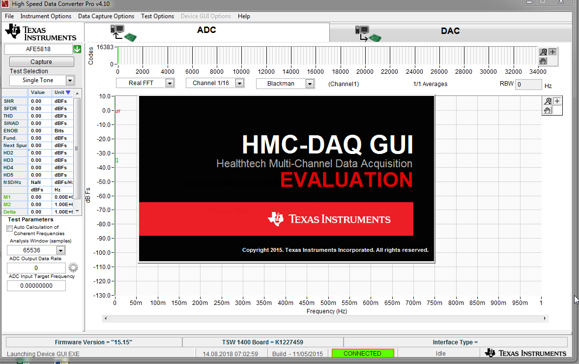

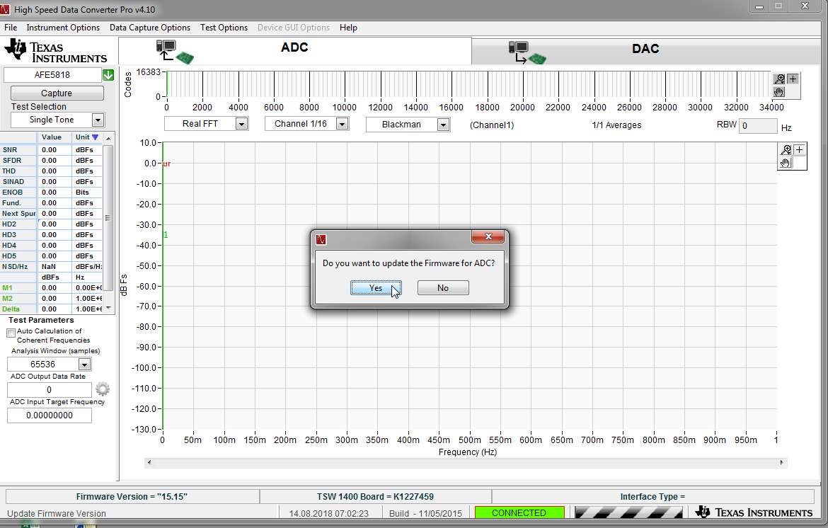

HW: AFE5818EVM + TSW1400; GUI SW: High Speed Data Converter Pro v4.90 + HMC DAQ GUI v2.8;
Observations:

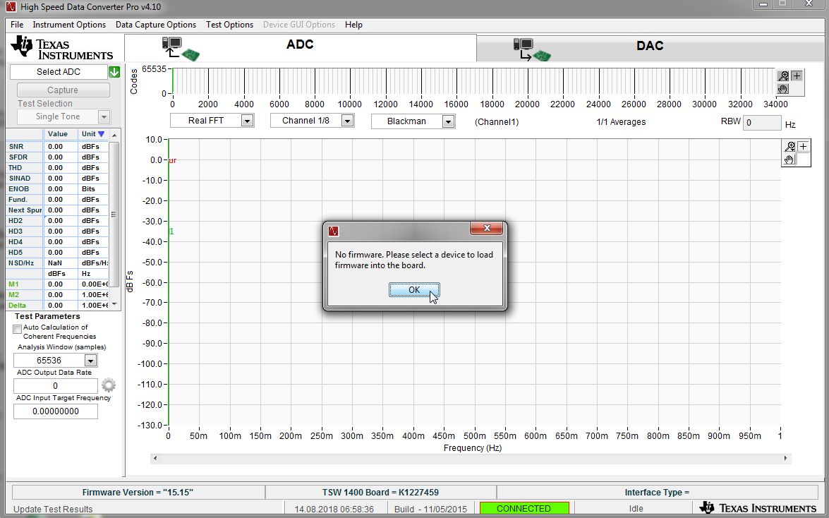

1. no LEDs are on after the firmware has finished downloading; no message appears in

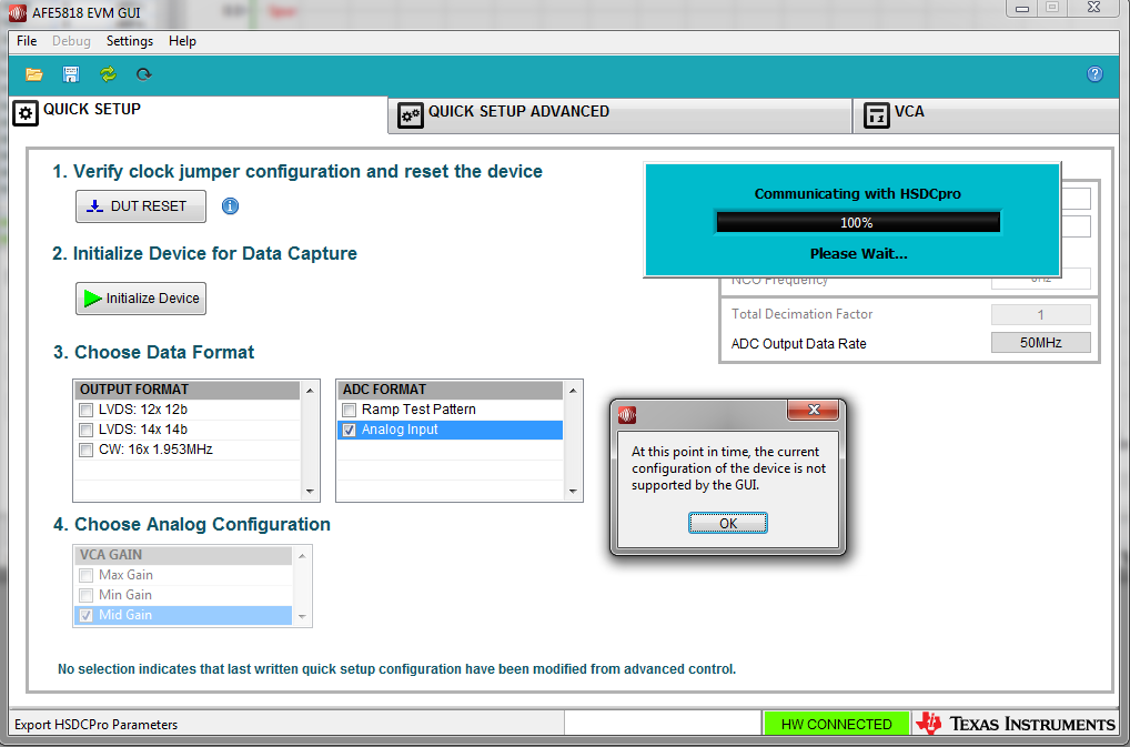

2. after having pressed the Initialize Device button on the HMC-DAQ GUI, status bar reached 100%, and then error:

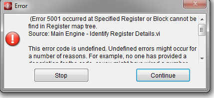

3. after clicking on OK, error window appears:
can anybody help me out? thanks!
  • Hello Wenqing,
    Welcome to TI E2E forum!
    The below issue occurs when the HMC DAQ GUI is unable to communicate with HSDC Pro through back channel because of the firmware not being downloaded properly into TSW1400.

  • Hello Praveen,
    Thanks for your quick reply!

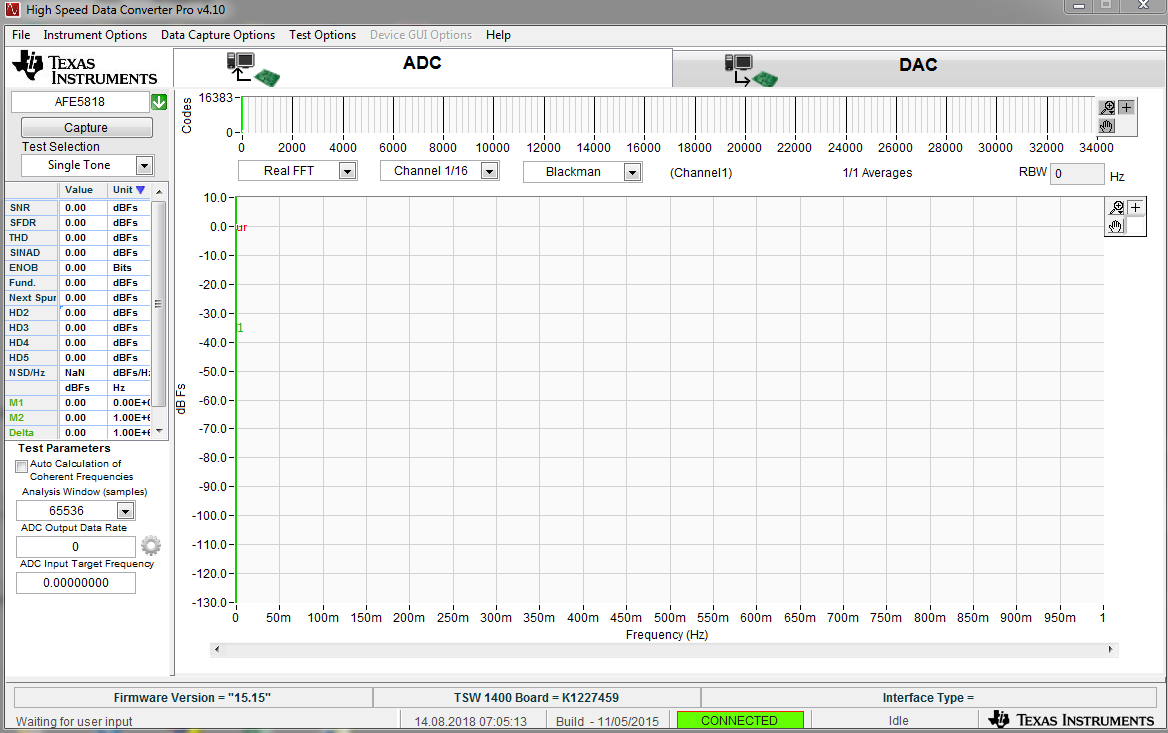

    1. I have not observed any error message while downloading the FW in HSDC Pro
    2. "ADC_FIRMWARE" does NOT appear behind "Interface Type = "
    3. some screenshots

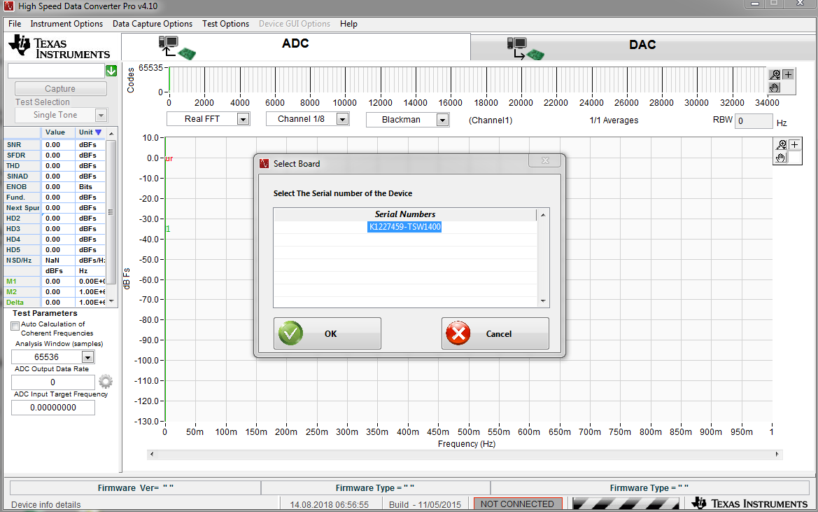

    3.1 connect HW in HSDC Pro
    3.2 select a device to download FW

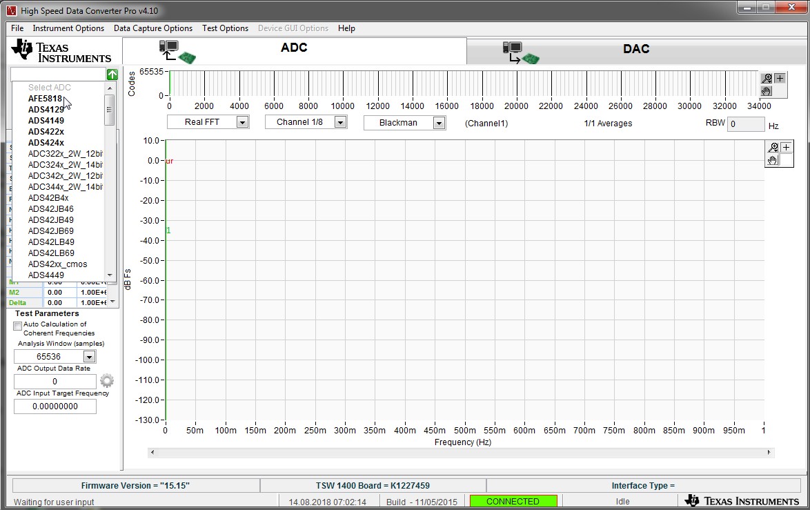

    3.3 select AFE5818 via drop down list
    3.4 confirm to download FW

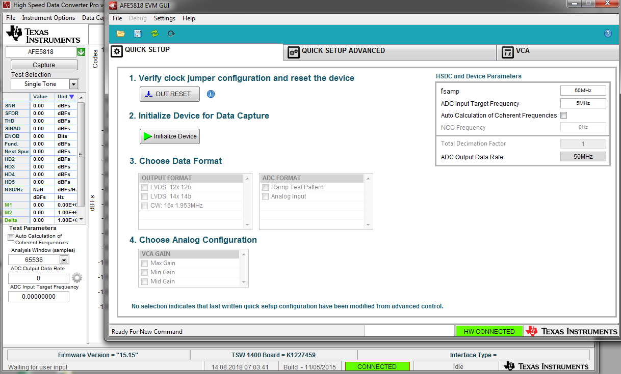

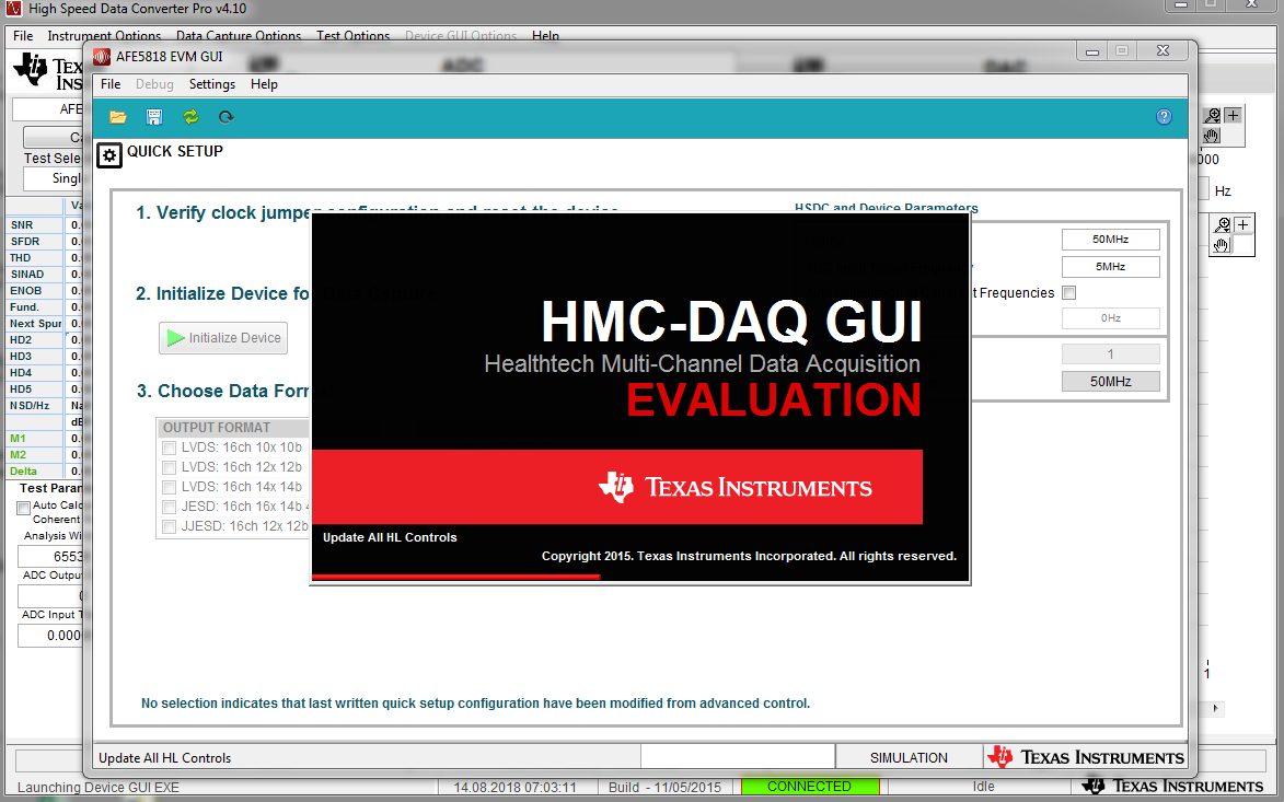

    3.5 HMC DAQ GUI pops up automatically
    3.6 HMC DAQ GUI starting
    3.7 HMC DAQ GUI ready for new command

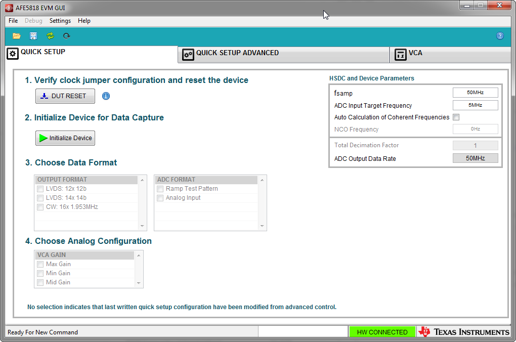

    3.8 Screenshot_HSDC Pro
    3.9 Screenshot_HMC DAQ GUI
  • Hello Wenqing,
    We have a few questions.
    • What is the Current limit from the supply?

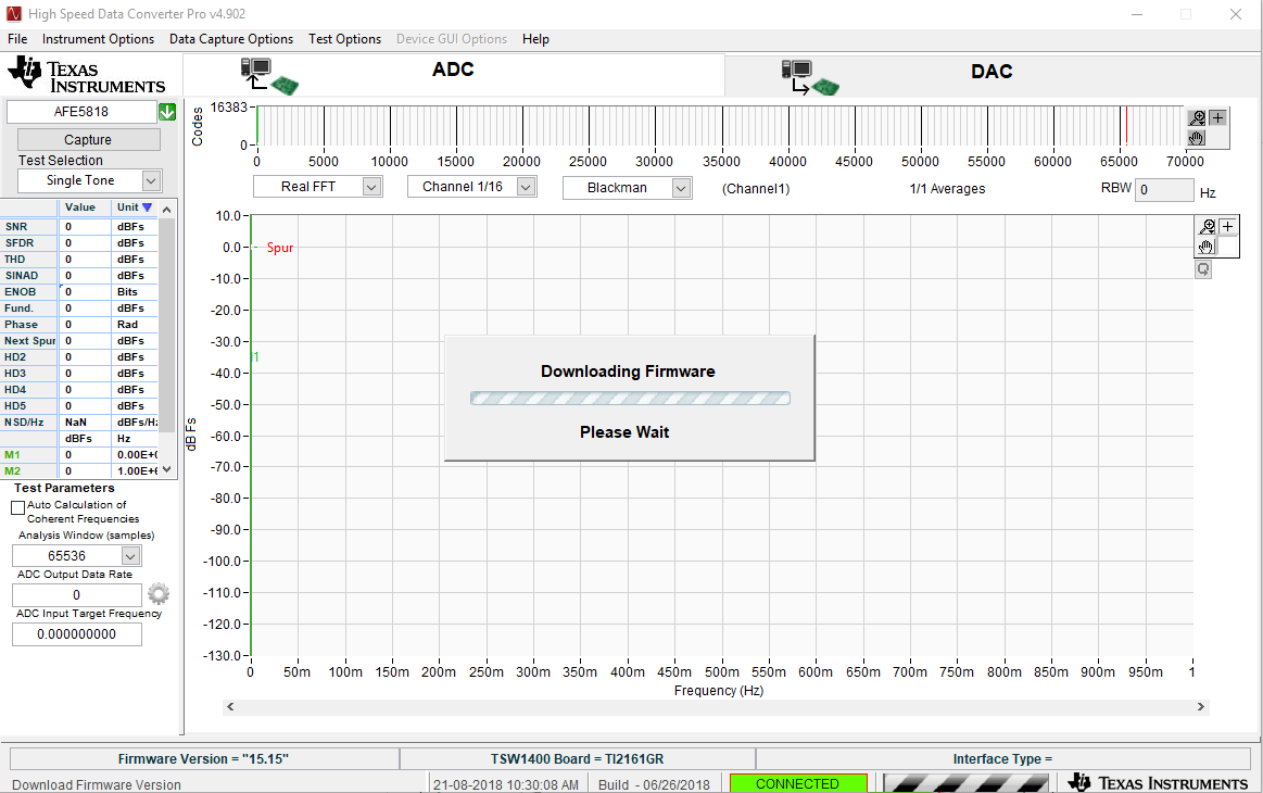

    • Did you try downloading the firmware separately from the menu? Instrument Options -> Download Firmware -> Select "ADC_FIRMWARE.rbf"
    • Were you able to see the “Downloading Firmware” Prompt similar to below image,
    • Can you provide a screen shot of the status log after double clicking the status bar to check for any errors after selecting the device?
