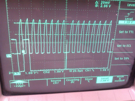

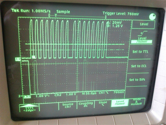

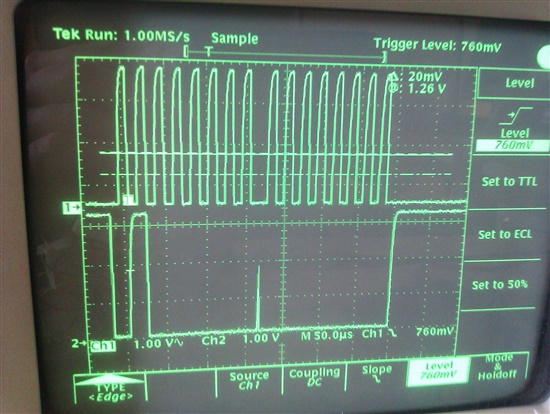

    I took a pic of my scope and what i get trying to read the register CONFIG0.
    Top: SCLK, Bottom: DIN: 0x40:
    Top: SCLK, Bottom: DOUT with random data. What you cannot see in the image is that the data sent over DOUT changes all the time

    What i notice now that i took the picture is, that the ADS1258 seems to clock on both, rising and falling edge....  What could be the reason for that?

    Still your explanation of my scope images does not seem to apply, because if you look at the frequency i was clocking in that picture i posted, you see i am at 50kHz and the SCLK high or low pulse width is only 10u, and the DOUT also drops low again after 10us....
    I am not sure what was the reason there, it looks better now, so ... whatever...
