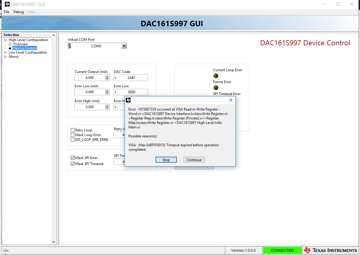

I'm trying to test the DAC161S997EVM through the accompanying LabView software. I'm trying to write a test value to the DAC board by selecting an output current in the DAC161S997 software, but an error continuously pops up with a timeout expired error (1073807339). Screenshots attached. I dont know if its a hardware or a software issue.
The device is being recognized but cannot be communicated with.
Drivers are up to date.
Even attaching the current loop makes no difference.

    It seems like the there is a communication issue between the EVM software and EVM board. I can replicate this error and receive the exact error message if I disconnect the loop supply from the EVM during use and try to write to a register. Do you have the loop supply connected the whole time you are using the EVM? I notice that the COM port will still show up without a loop power supply connected but this timeout error occurs.
    What are the steps you took before receiving this error message? Also, what happens if you click continue?
