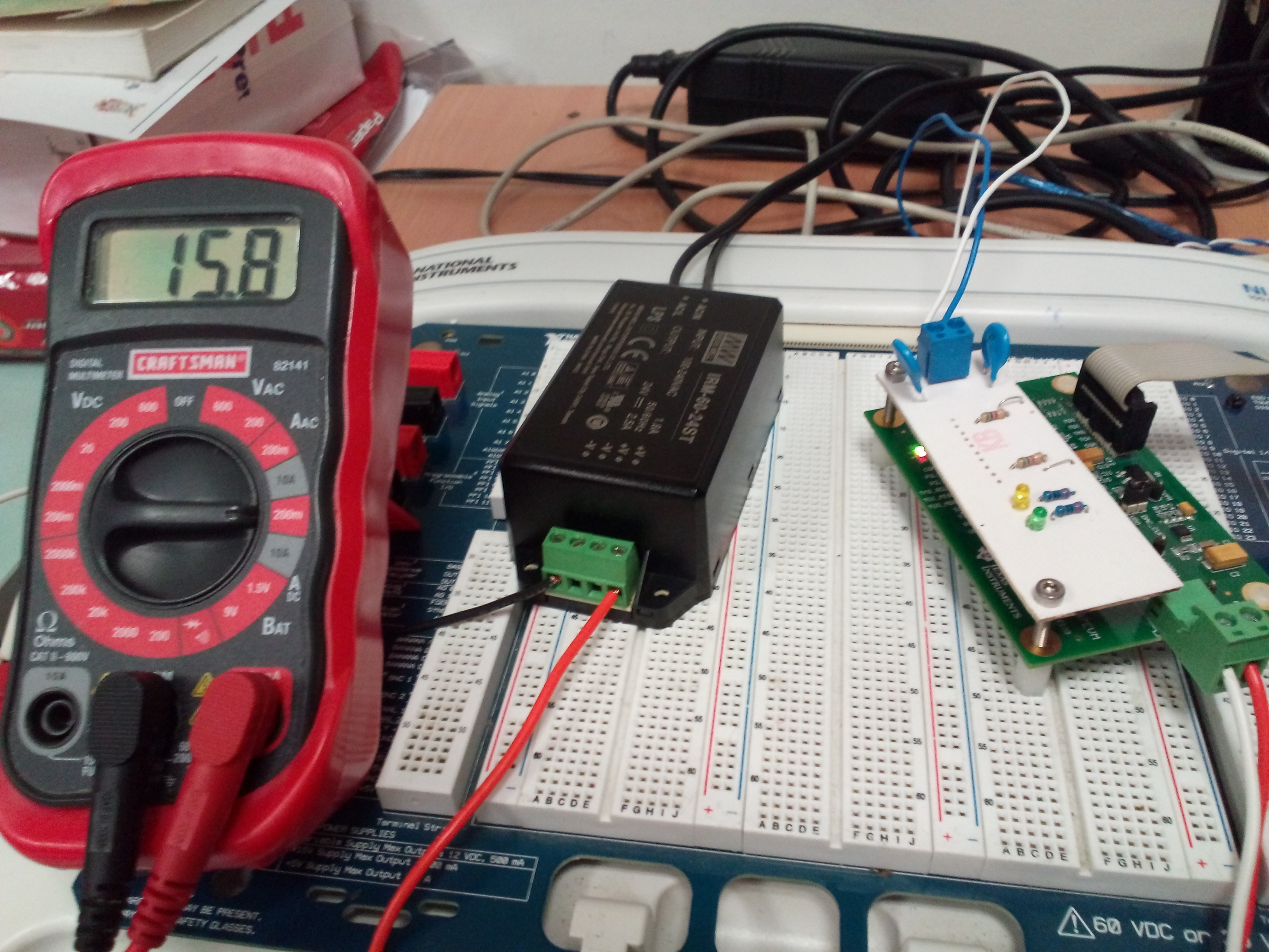

    We modified the firmware of  DAC161S997EVM  to control of DAC161S997   but we can`t  control de output . The figure shows the unique value powered by EVM
  • Hi Miguel,
    Were you able to control the loop current with the EVM software? This would verify your hardware setup. How are you connecting loop+ and loop- and how is the additional board connected?
    Are you able to read back the registers you have written? It would be helpful if you could provide SPI scope captures that include SCLK,SDO,and CSB to ensure the SPI frames are correct.
