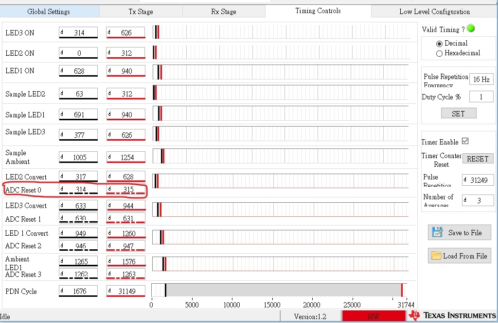

Dear TI,
When I use the AFE4404 EVM GUI (ver 1.2), the ADC Reset 0 only calculate 1 count.

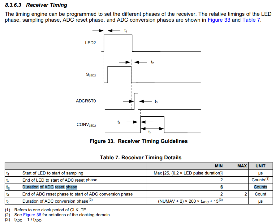

But datasheet shows that this counts need over 6 count.
Which one is right?
I look forward your help.
Thank you.
    Programming CLKDIV_PRF could result in lower ADCRST pulse as it changes the clock to the timing engine.
    So please check CLKDIV_PRF setting and try with the default setting to confirm that indeed the ADCRST pulse is set to 6 clocks.
