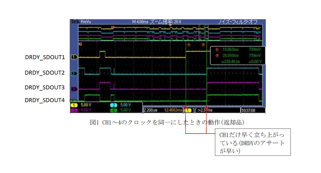

Our customers are using Synchronizing Mutliple with Four ADS 1212.
Writing 0xe 3 to command register byte 3
Pull up the DSYNC pin.
Only one DRDY will assert early.
The customer's figure uses DRDY and CLK inverted.
Why is DRDY not at the Synchronous timing?

    The customer should not be using both register write of the DSYNC in the command register 3 and the DSYNC pin in the same synchronization sequence as this will create confusion as to when the DSYNC should actually take place.
    For all converters to be synchronized, the same clock, turbo mode and decimation should be used. It would appear that in most cases the alignment is correct for DRDY and the zoom shot shows device 1 is off in this case. If there is a state error from using 2 methods of synchronization there could be an issue. So again, I suggest using just one method.

    In general, the rising edge of a pin signal is easier to decode as opposed to a command register write.  As I do not have a schematic to review the communication signals or how the DSYNC pin might be controlled it would be difficult to say if there is one method better than the other.
    For the command register write function to synchronize properly, all devices must be written at the same time using the same command sequence.  As this process requires communicating to 4 devices with 4 separate CS lines, this would seem more complicated than pulsing the DSYNC pin.
