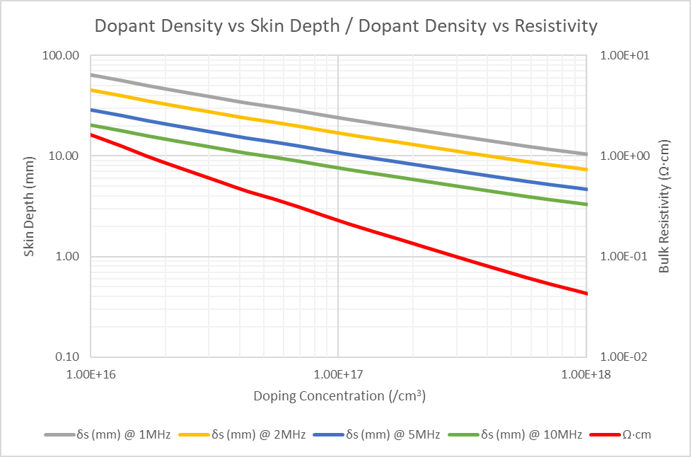

    The graph below shows the resistivity and calculated skin depth for different frequencies vs the expected dopant density range.
    The LDC Target Design document states:
    “With a conductor of 3 skin depths thick, 95% of the total current will be induced…To achieve best performance, a good rule of thumb is to that the target thickness should be at least 2 to 3 skin depths.”
    For the dopant density range I would like to analyse, a minimum frequency of 2MHz is required so that the target material depth (150mm) is greater than 3 times the skin depth.
    I have created the following graph that shows the LC tank design restraints.
    3. Are there any design constraints I have missed?
    4. From this window, how should I proceed in choosing an LC combination?

    3/4. This is a very helpful graph. The only other design constraints I would consider are the sensor frequency and the inductor Rp (or Q) value when the target is present. The conductive target will decrease the inductor's Rp and increase the sensor frequency. I would recommend choosing LC values that give you a sensor frequency of about 5MHz, then test to make sure that the sensor characteristics are within the recommended operating conditions when the target is the minimum distance from the sensor coil.
