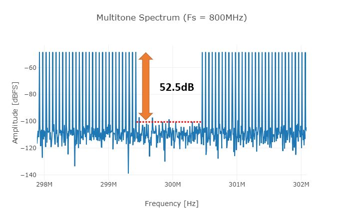

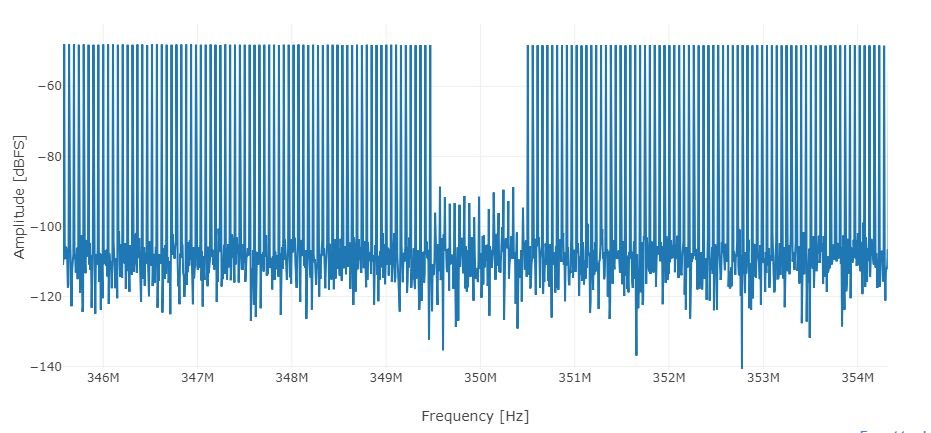

    I encountered strange phenomena for FFT spectrum on ADS54J60.
    Attached figures please confirm the amount of distortion.
    ・Default (without any additional resister setting)
    ・Freeze Interleave Engine

    The distortion of multi tone has been reduced when interleave engine froze.
    But JESD204 link was disconnected without a return to unfreeze state immediately.
    From this phenomena, ADC interleave mismatch is strongly suspected for the distortion.
    I would like to get your feedback about this issue.

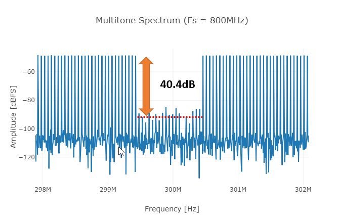

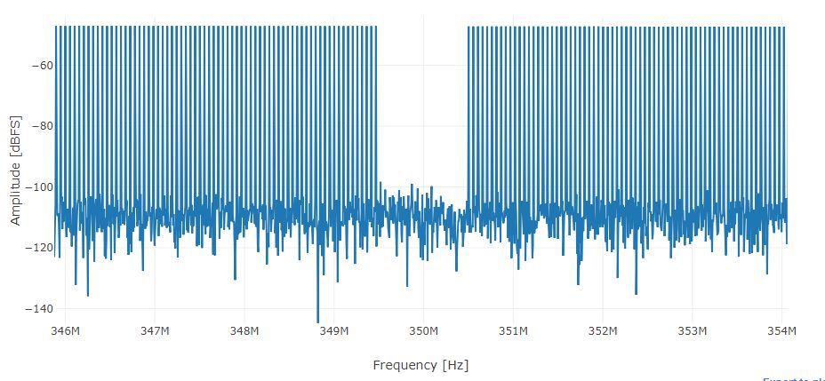

  • Dear Jim,
    The following resister setting has strong influence for Multitone Power Ratio.
    0x4004 0x68
    0x4003 0x00
    0x4002 0x00
    0x4001 0x00
    0x604D 0x01         // Must wirite 0 in datasheet. But I modified.
    0x6068 0x04         // There is no information in datasheet.
    ・Before set above resister (Default)
    ・After set above resisters
    I'd like to get more information for  the role of hidden resisters.
    Could you please explain "IL Engine" and provide information for hidden resisters?

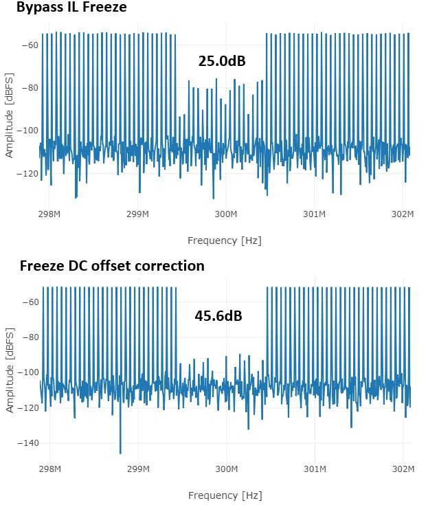

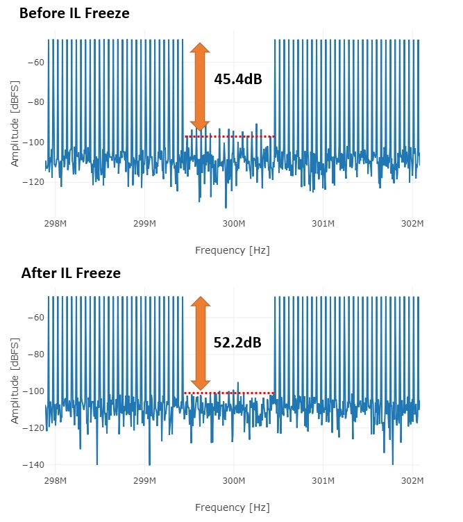

    The only adjustments for the IL engine is to freeze it, unfreeze it, or bypass it per the instructions attached. Have you tried all three? When freezing the engine, make sure to reset the digital core first and wait 2ms. There also was a feature update added to the register map. See if this register write helps. Have you tried freezing offset correction to see what effect this has with your setup?
    Jim
    Thank you for providing the document.
    I've been tested IL freeze setting by following the document.
    JESD204 link is more stable than before.
    IL engine freeze seems to be effective to improve the distortion.
    In addition, both IL bypass and DC offset freeze have been measured.
      IL bypass :  Quite poor performance for Multitone Power Ratio
      DC offset freeze : No relation to this issue
