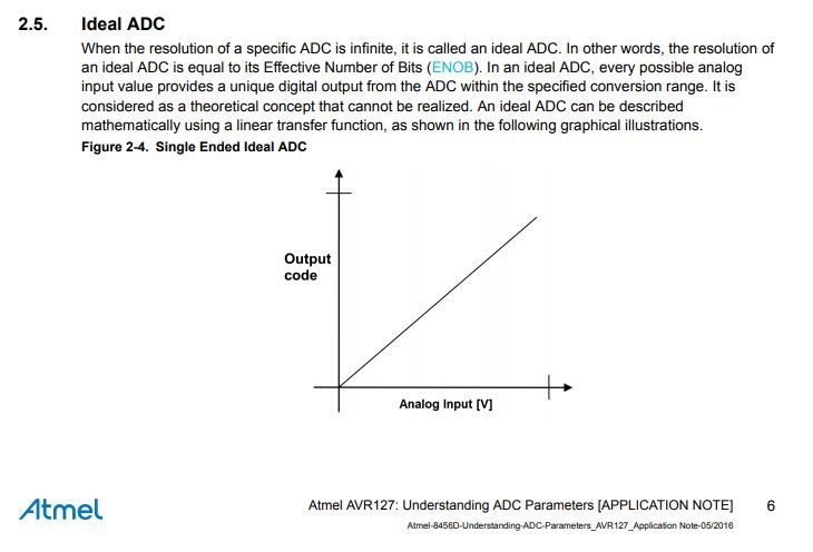

Please find the attached.We know that ADC 1LSB=Vref/(2^N) where N is the resolution of the ADC.
We know that ADC Effective number of bits (ENOB) is always less than the resolution "N".
When calculating 1LSB do I need to take 1LSB = Vref/(2^ENOB) or I need to take  1LSB=Vref/(2^N)
