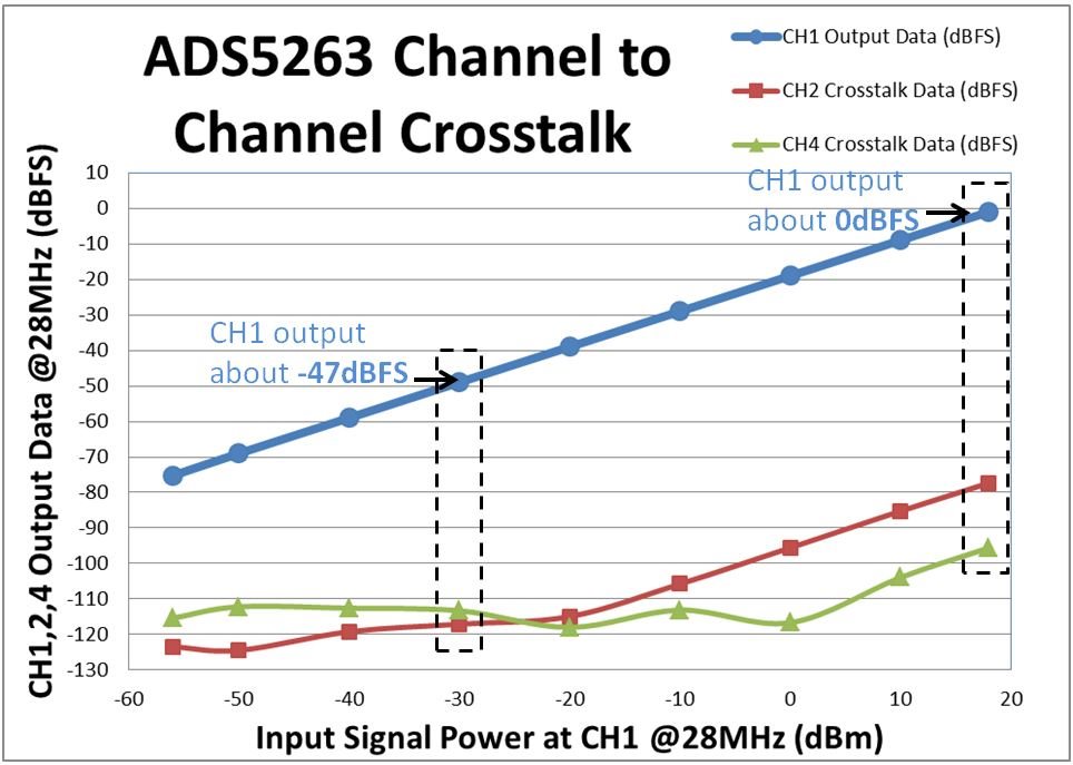

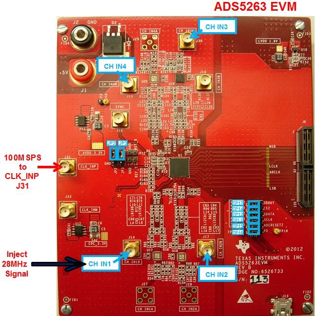

Hello folks.
I have a problem with internal crosstalk between channels in ads5263.
The situation is as follows:
when power of input signal is 0 dBm at frequency 28 MHz, decoupling between channels is about 90 dB, but when input signal power down to -30 dBm, decoupling between channels became 40 dB.
Why does this happen?
