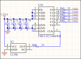

I have ADS5263 in my design,schematic as below:
CLKP is a single ended 12.5M 3.3V CMOS clock.
When I debugged the board, I found the ADCLK and LCLK is not related to CLKP.
The ADCLK and LCLK have the same output as I remove R45 and keep the CLKP Pin floating.
It seems the PLL in ADS5263 is not locked and behave like there is no CLKP input.

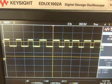

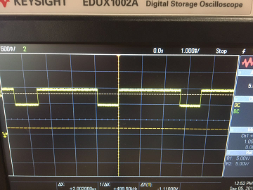

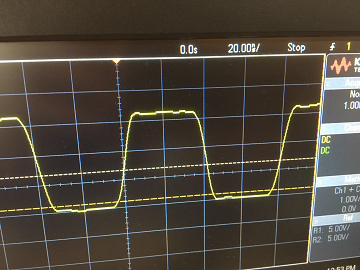

 CLKP wave: 12.5MHz, 3.3V CMOS
ADCLKP: about 300Hz clock, duty cycle is not stable
LCKP: about 4kHz, duty cycle is not stable

  • The waveforms that I attached are with CLKP Pin have 12.5MHz, 3.3V CMOS.
    I mean that weather or not CLKP Pin is floating, output of the ADCLKP and LCKP is the waveforms that attached.
    I am thinking the CLKM shouled not be connected to GND. A capacitor should be connected between CLKM and GND to keep CLKM biased.

    Could you please try the following methods
    on your own board schematic as below?
    Thank you!
    1) Please connect a capacitor (0.1uF) in series between your CLK1 signal (from your board) to CLKP (CLK+) clock pin.
    2) Please connect a capacitor (0.1uF) in series between your Ground signal (from your board) to CLKM (CLK-) clock pin.
