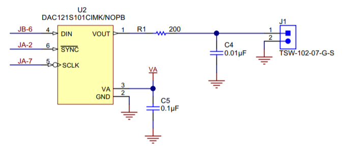

I noticed this DAC is spec'd to have a max load capacitance of 1.5nF.
The EVM has a 10nF capacitor, which I am assuming is okay because of the 200-Ohm series resistor on the output.
Is there anyway to determine if this would be stable with a 50-ohm resistor? Or can you confirm? It would be a shame to spend $50 to do one small test.
Thank you,
