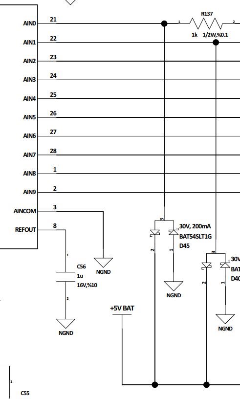

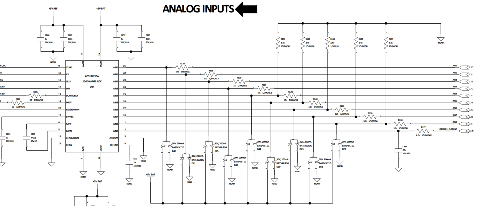

So, I post my schematics first :
Circuit Details :
1) AIN0-AIN1 have 100 ohm ADC input resistors.
2) AIN2-AIN3 have 1kohm ADC input resistors. ( I am trying to achieve 1 mV accuracy with these two inputs )
3) AIN4-5-6-7-8 have 12k/2.4k resistive dividers to make these inputs 30V compatible.
4) AIN9 is used to monitor a current in the other part of the board.
5) All inputs except for AIN9 have Schottky protection diodes.
6) I use REF5050  5V reference voltage ( as it is better than internal reference). Reference voltage is connected to AVDD pin of ADS1262 in order not to lose any analog inputs.
7) I think layout is pretty good as well with ADC basics are all taken into consideration.

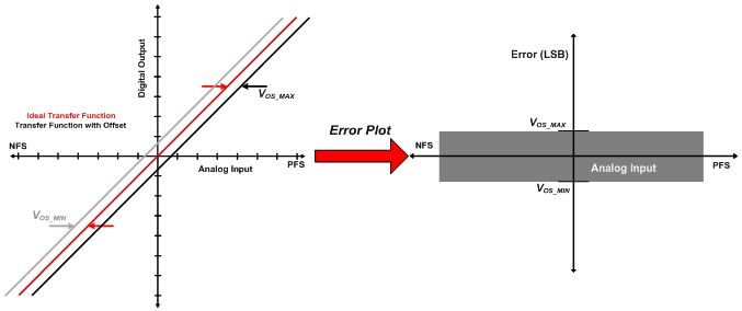

Offset error shape would be :

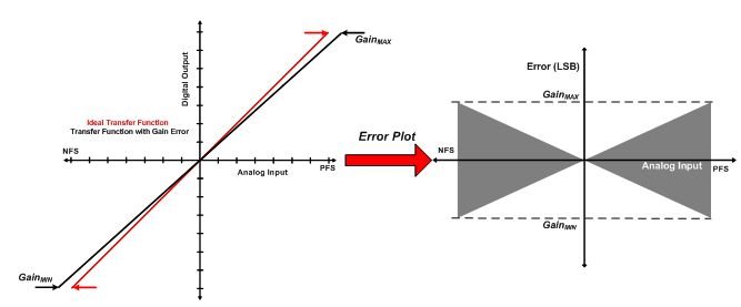

Gain error shape would be :
So, my error looks more like a gain error. As i turned off PGA , i would expect my absolute error to be more like a flat error of offset error. This is obviously not the case.

    • Reference voltage errors will take on a similar effect as a gain error (and result in the "bow-tie" shaped plot). The REF5050's initial accuracy of 0.05% is already 5x times higher than your targeted accuracy (assuming a 100% FS input signal). At 20% FS (i.e. 1V) the "gain error" of the reference causes an approximate 1mV error. Granted this is a maximum error specification, not a typical, but it still gives an idea of what can be expected without performing any calibration to compensate for this error. Second to the initial reference error, the reference source's temperature drift is also somewhat significant (3ppm/degC max, means a possible 30 ppm MAX error with only a 10 degC temperature swing).

    In summary, I think you are seeing a large gain error in your system. Even without using the internal PGA, the delta-sigma modulator will still have some inherent gain error; AND, since the ADC is comparing the input signal to the reference voltage, any error in the reference voltage will translate into a gain error seen in the ADC's output. Since the initial reference accuracy is pretty key to your system, is there any way you might be able to take advantage of the REF5050's trim pin to perhaps tune the reference voltage? Otherwise, I think calibrating your system will probably be the easiest way to achieve your target accuracy.

    3) Schottky diodes are very good point and actually i suspected them too but i thought that the way they are connected wouldn't create "bow-tie" error shape :
    Both BAT54 schottky diodes are in reverse-mode.
    + For 0V input;  BAT54 on the left has 5V reverse voltage, BAT54 on the right has negligible reverse voltage.
    + For 5V input;  BAT54 on the left has negligible reverse voltage, BAT54 on the right has 5V reverse voltage.
    So, i expect that effect of diodes should be same for 100mV input and 4900mV. In both cases, roughly same error current will be sourced-sunk by BAT54 diodes. But let's assume as if this is not the case.

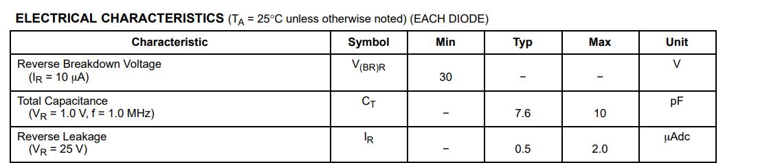

    From BAT54 datasheet :

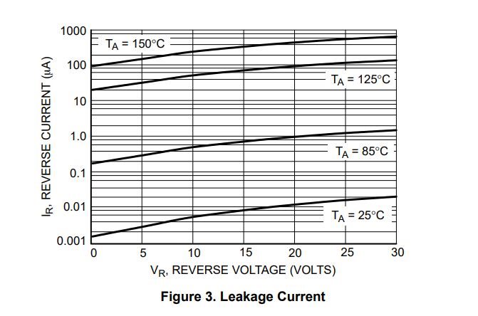

    BTW, i am unable to make sense of BAT54 datasheet : IR = 0.5 uA typical ( 2 uA max.) is specified for 25 C in the table. But in the graph at 25 degrees, it is more like 0.02 uA. That's a huge difference. I suspected ONSemi and checked Diodes Incorporated counterpart and it is exactly same.
    Anyway, taking the worst-case value of 2uA for VR=25V, I estimate that ( according to graph), for VR=5, the leakage current should be at least 10 times smaller. ( due to logarithmic graph). Let's take 0.2uA for VR=5V. That would create 0.2 mV error over 1k input resistor.  That value is not insignificant but still too low to explain my large error. ( and i used worst-case values)

    I think the reference voltage error is more likely to be the dominant source of the "bow-tie" shaped error than the diode leakage current, as long as the diode leakage current is less than 1 uA. NOTE: Above 85C the leakage current increases exponentially with temperature and around 1uA leakage the induced offset voltage across the 1kOhm series resistor becomes an issue.
    From figure 3, it looks like leakage current just about doubles from VR = 0 to VR = 5V; however, you are right that the figure does not appear to agree with the Electrical Characteristics tables of the BAT53SL datasheet.
