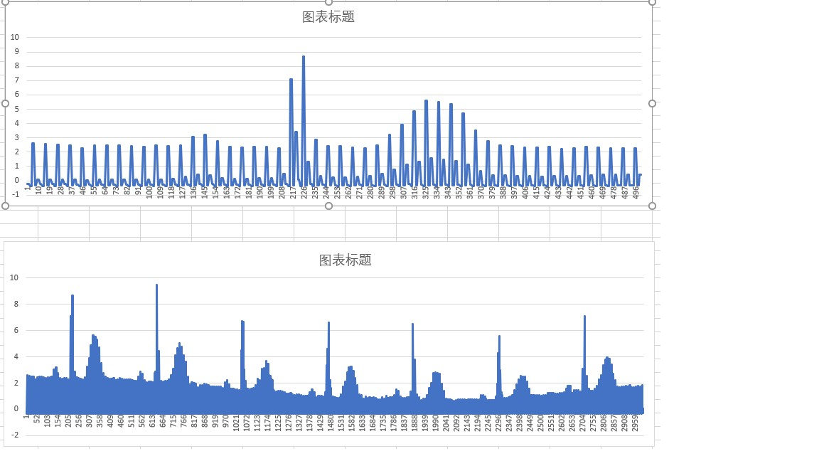

    I have received the ECG wave data samples. The input signal is normal ECG wave with a heart rate 72. But my received ECG wave samples look strange. The ECG wave I received from ADS1292 is like this, see the attach file. The sample rate is 500.
    Why does the wave look like this? If the small peaks is because the power frequency interference, why does the interference peak so high?
    I don't know if the wave is correct, or it is correct , just need filter. Please give some advice base your experience.

    It's good to hear that you resolved your SPI communications issues. The zoomed in portion of you wave form looks reasonable to me, the higher peaks may be due to 50/60 Hz or 'motion artifacts'. Since your original question was related to your SPI communications, I'm going to close this post for now. Keep up the good work!
